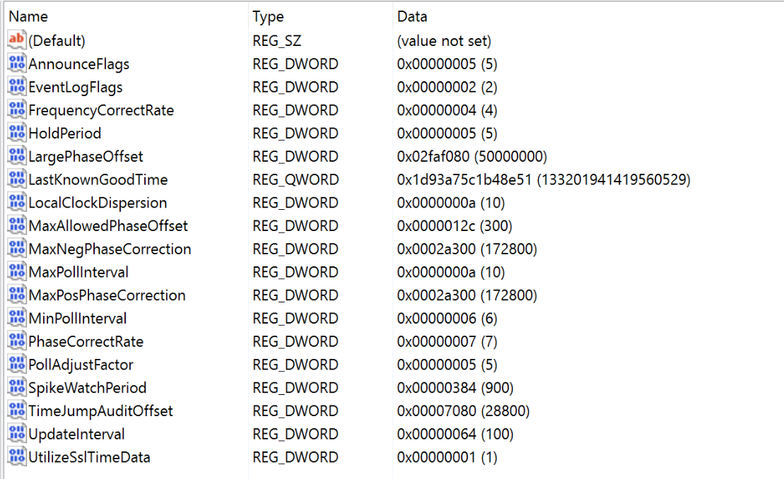

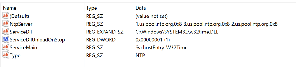

I cannot change time source from Local CMOS Clock to NTP server on PDC Emulator. This is the PDC which is a VM running on Hyper-V. Windows Server 2016 Standard. This has functional level of 2012 R2.
Here is the config and the parameters

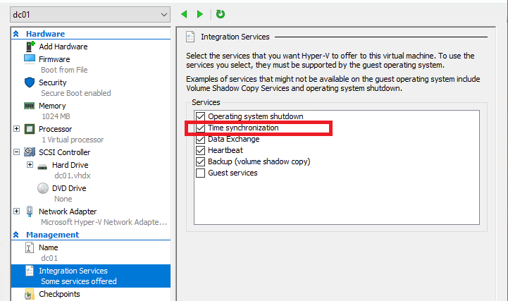

    Hello Tom
    this is because the VM has an option to automatically synchronize the time with your host server. (and this precedes your configuration) In your case, open the VM properties from hyper-v, and disable the time synchronization option. after that, repeat the procedure already performed. it will work.

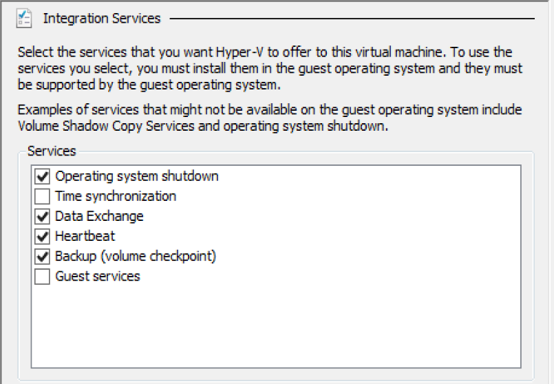

  2. Tom Westfall 0 Reputation points
    2023-02-06T23:28:05.4266667+00:00
    I actually turned that off on all servers about 6 months ago or more.
