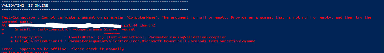

I am trying to fix a script that was working below is the piece of code that is causing the problem:
param ([Switch]$detailed)
Clear-Host
Function VALIDATEDCONLINE
	param ($server)
	$Global:DCOnline = $Null
	"VALIDATING $SERVER IS ONLINE"
	$result = test-connection -computername $Server -quiet
	if (!$result)
		Write-host -ForegroundColor Red "Error, $server appears to be offline. Please check it manually"
		write-host -ForegroundColor Red "Moving to next server..."
		$Global:DCOnline = $false
	else
		Write-Host -ForegroundColor Green "$server is online. Beginning DCHealthCheck"
The Error I am getting is:
How can I fix this PARM issue?

  1. Joseph Patrick 641 Reputation points
    2020-10-05T19:54:59.423+00:00
    The piece of script that should be passing the server name is below, the Item listed ($Servers = $input) seemed to be the culprit, I removed the S and it fixed the script:

  1. Rich Matheisen 47,901 Reputation points
    2020-10-05T18:49:58.11+00:00
    You fix it by passing the name of a computer when you call the function.
    VALIDATEDCONLINE computer-name
  2. Rich Matheisen 47,901 Reputation points
    2020-10-05T19:24:23.583+00:00
    I did give you an example!
    How about this:
    VALIDATEDCONLINE  REPLACE-THIS-STRING-WITH-THE-NAME-OF-A-COMPUTER
  3. Rich Matheisen 47,901 Reputation points
    2020-10-05T19:42:24.6+00:00
    Your function is really isn't necessary. But if you want to use it you might consider using in like this, after making sure the parameter's been suppled and eliminating the unnecessary use of a global variable.
        param (
            [Parameter(Mandatory=$true)]
            [String]$server
        if (test-connection -computername $Server -quiet){
            $true
        else{
            $false
