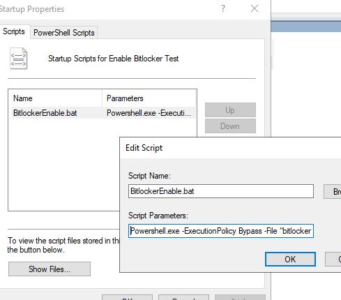

Here is the configuration for my startup script. Basically The script includes 1 line to enable bitlocker which requires administrative privileges to run the batch script. How do i pass the parameter so my batch script runs at startup
My script parameters are powershell.exe -executionpolicy bypass -file "bitlocker.ps1"
The batch file content is
@Echo off
manage-bde -on C: -recoverypassword -skiphardwaretest
when i run the script as an administrator locally, the script runs fine, so i believe it has something to do with parameters i have passed on. Can someone help me out with this question ?

  3. Chauhan, Aniket 10 Reputation points
    2023-02-09T16:28:34.9533333+00:00
    Hi everyone,
    As Daisy mentioned, i have the script setup in the same location, although it is a batch script. If i run my script locally as an administrator, it turns on the bitlocker just fine but the script does not run through GPO. I have also tried setting up the scheduled task but it does not run through GPO. what should be my script paramaters in the GPO for the batch script, is what i have setup correct ?
