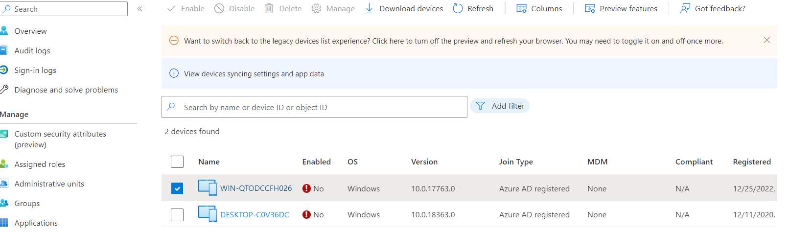

I was disabled all my device in device section because i wanna kick some one away my account. But my device was disconnected too and i try to enable with admin account but enable button is hide. So what can i do now?User's image

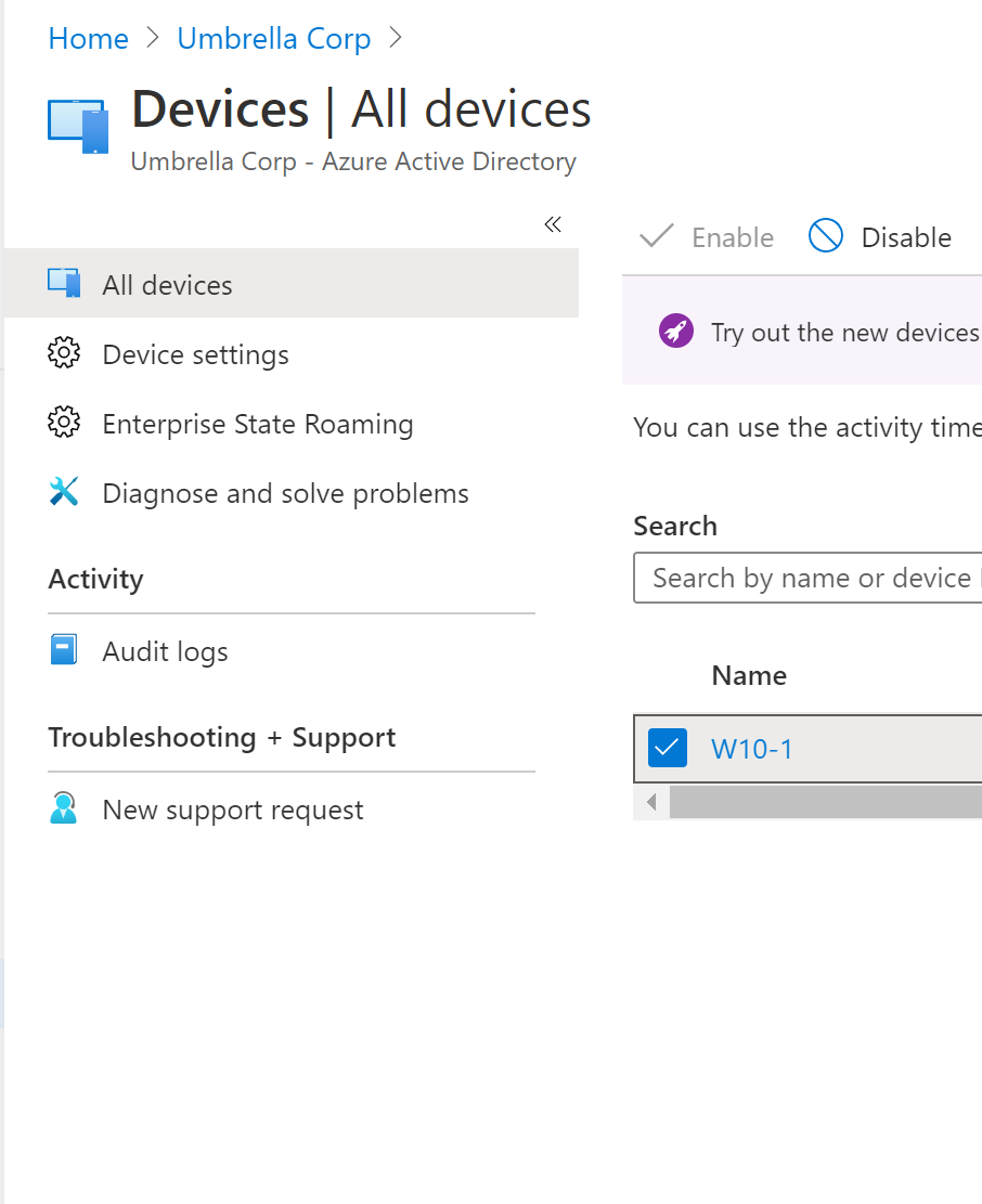

    If the device was disabled in Azure, the administrator will need to re-enable the device. The admin can go to Azure Active Directory > Devices > select the checkmark next to the device > Enable in the Azure portal.
