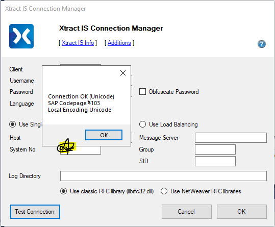

Though I am able to successfully create the Connection for Xtract IS using below connection type

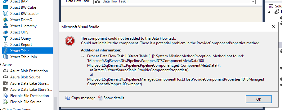

when I tried to access Xtract IS related componets in Data Flow Task, I am facing the below error,

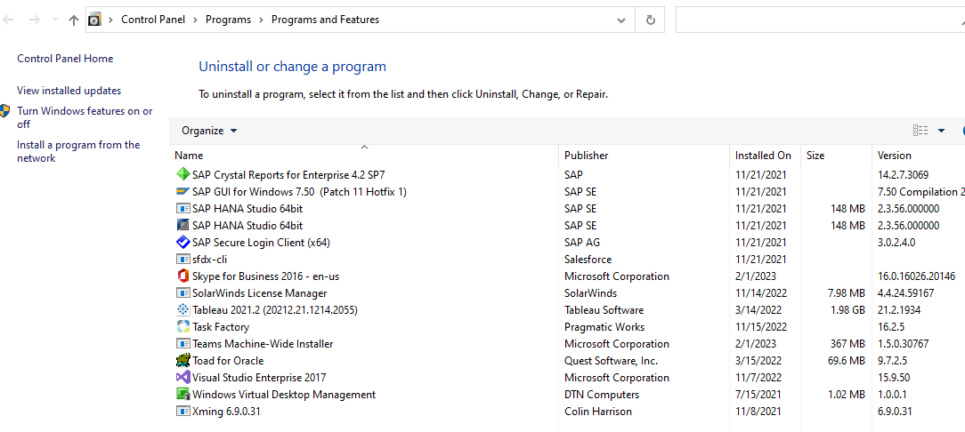

Also I could not see the Xtract IS installed folder in my Program Files/Add or Remove programs option but still am able to set up the connection though there is a issue in using the component.

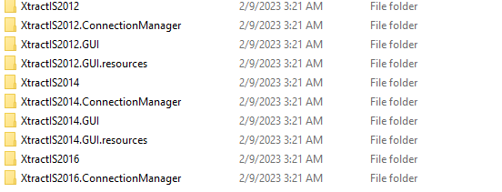

I have checked the Assembly folder 'C:\Windows\Microsoft.NET\assembly\GAC_MSIL' and could see the below connection managers though Xtract IS software installed.
My issue is that why am not able to use the Xtract components though I able to successfully set up the connection.

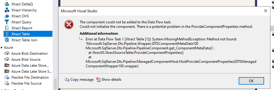

But still am not able to use the components and facing the below error while drag any Xtract related component into data flow.
Is this to any license related issue? Do I need to clear any folder to install it from scratch?
