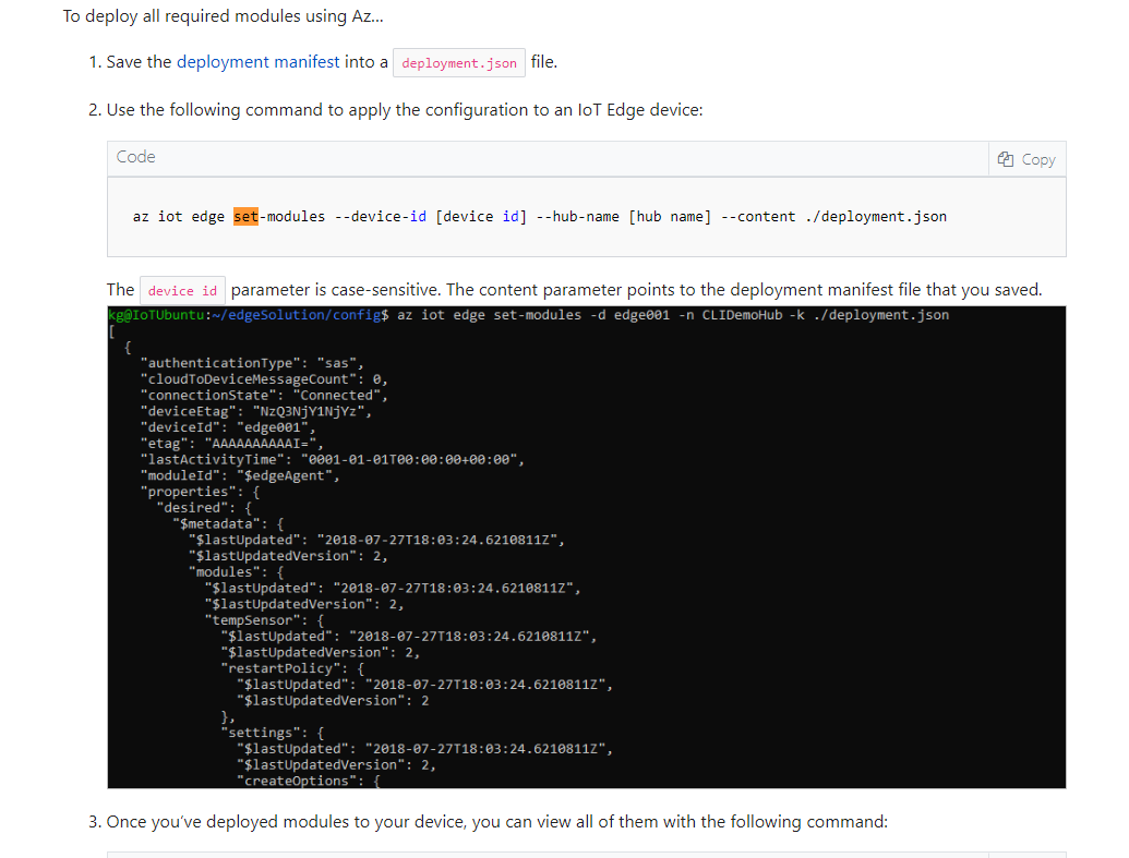

I need to create and delete IoT Edge Custom Module programmatically.
To create module I use Azure CLI command az iot edge set-modules and providing json content. This is working fine.
When I want to remove module I have tried the same approach but with content that does not include custom module. And this does not work. Module is still running only Specified in Deployment status changes to No
Is this behavior intended? If yes what is the way to delete module using Azure CLI?

    Regarding your initial query, yes, this behavior is intended. When you use the az iot edge set-modules command to remove a module, it only updates the deployment status of the module to "No" in the deployment manifest.
    The module is still running on the device, but it's not included in the deployment. If you want to delete a module from an IoT Edge device, you need to use the az iot edge remove-modules command. This command stops and removes the module from the device. Here's an example of how to use the command:
    az iot edge remove-modules --device-id [device id] --hub-name [hub name] --module-id [module id]
    • The device ID parameter is case-sensitive.
    • The module ID parameter is the name of the module that you want to remove.
