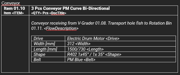

I'm struggling with an issue when trying to create nested tables in word from Inventor iLogic 2022 (basically VB.NET)
What I'm trying to achieve is something like this:

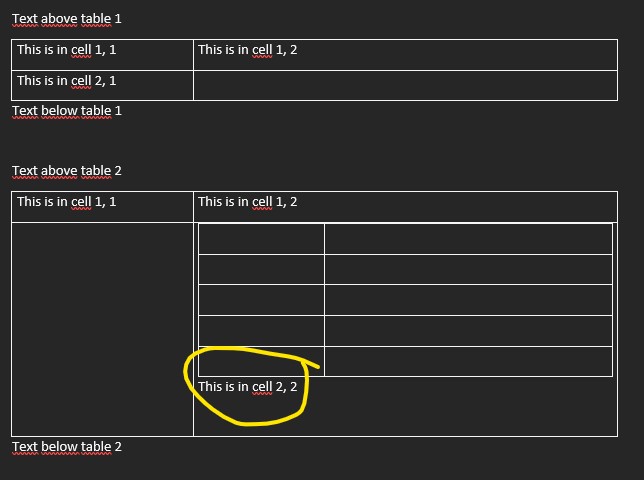

Text, 1. level table and texts in 1. level cells are working as intended. Even inserting a 2. level table into a cell seems to work. The issue arises when I want to include a text and then a table in the same cell (line 16 and 17). No matter what I do I end up with the table on top of the cell and the text below. Like this:
I've posted a simple test code below. I don't quite understand the "Range" object and believe this is why I can't get this to work as I want.
The code needs to be easy to edit by a non-developer, and build the entire word document from "Sub CreateWordContent". The finished document will consist of many different versions of the table in the image above.
Any and all help would be appreciated. I've tried searching the forum, google and ChatGPT, but haven't found the missing piece yet.

	InsertTextInCellLf(2, 2, "This is in cell 2, 2")
	InsertSecondaryTableInCell(2, 2, 5, 2, 30, 68)
