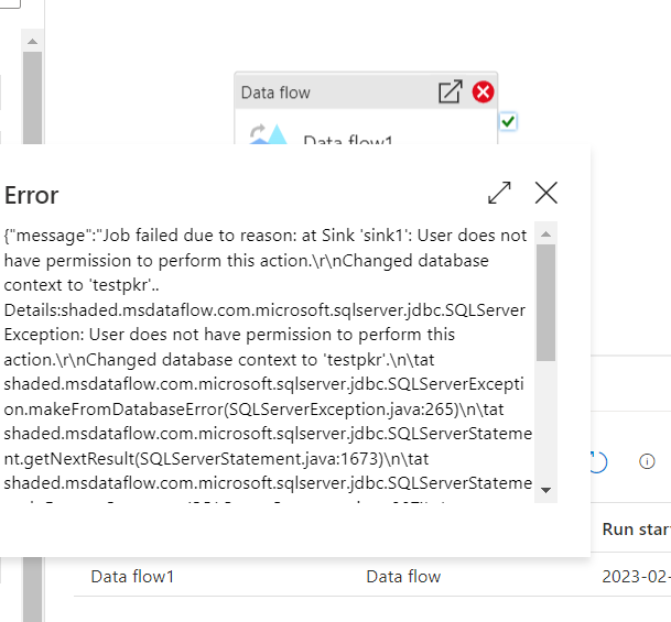

Synapse error from the pipeline when I tried to perform the DML operations.
Operation on target Data flow1 failed: {"StatusCode":"DFExecutorUserError","Message":"Job failed due to reason: at Sink 'sink1': User does not have permission to perform this action.\r\nChanged database context to 'testdb'.","Details":"shaded.msdataflow.com.microsoft.sqlserver.jdbc.SQLServerException: User does not have permission to perform this action.\r\nChanged database context to 'testdb'.\n\tat shaded.msdataflow.com.microsoft.sqlserver.jdbc.SQLServerException.makeFromDatabaseError(SQLServerException.java:265)\n\tat

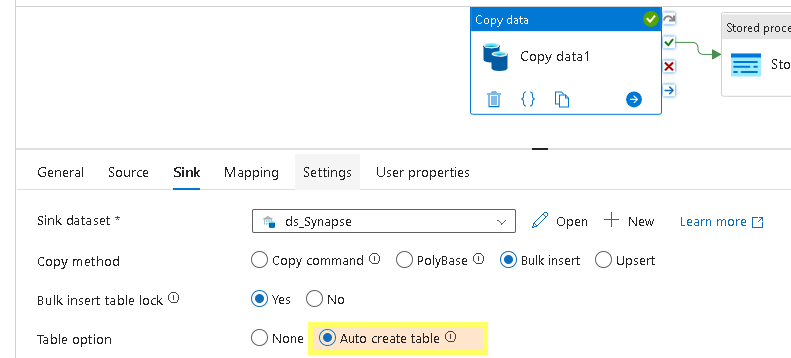

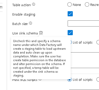

    I think I have a repro and this only happens when you have AutoCreate table option is set in the copy activity.
    Error
    ErrorCode=SqlOperationFailed,'Type=Microsoft.DataTransfer.Common.Shared.HybridDeliveryException,Message=A database operation failed with the following error: 'User does not have permission to perform this action. Changed database context to 'synapse'.',Source=,''Type=System.Data.SqlClient.SqlException,Message=User does not have permission to perform this action. Changed database context to 'DBAName'.,Source=.Net SqlClient Data Provider,SqlErrorNumber=6004,Class=14,ErrorCode=-2146232060,State=9,Errors=[{Class=14,Number=6004,State=9,Message=User does not have permission to perform this action. Changed database context to 'synapse'.,},],'

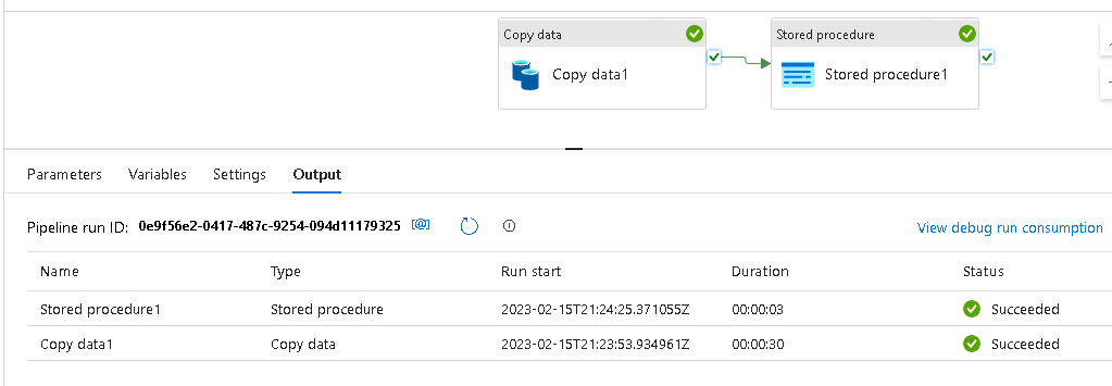

    Solution is to provide the User (in your case test) the required permission.
    GRANT CREATE TABLE TO test
    Let me know how its goes
