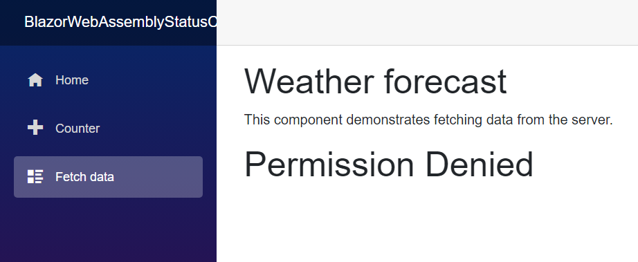

    According to the loop code I added, if it successfully catch the 401 status code, it will show the access denied message. I added a breakpoint to test it and here is my test result:
    You can see it successfully enter the loop, you can change the code to the action you want. In that case, blazor will not enter the exception.
    Here is the blazor web site of the testing result:
