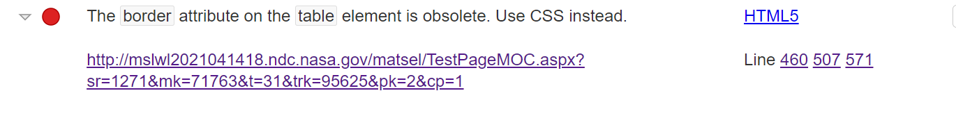

We use Gridviews in a number of pages. We use a 508 accessibility software suite to check our pages for accessibility and standards compliance.
No matter what we try, we always get this non-compliance for our Gridview:
"The border attribute on the table element is obsolete. Use CSS instead. "
(We also get this for rules, cellspacing, etc.)
We are not specifying an explicit border attribute. It appears to be coming from the table generated by the Gridview. We ARE using css to style the table.
We cannot "make" this go away. Surely someone else has run into this issue? Not to put to fine a point on it, why is Gridview generating HTML code with deprecated attributes?
