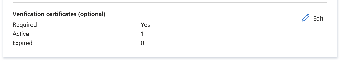

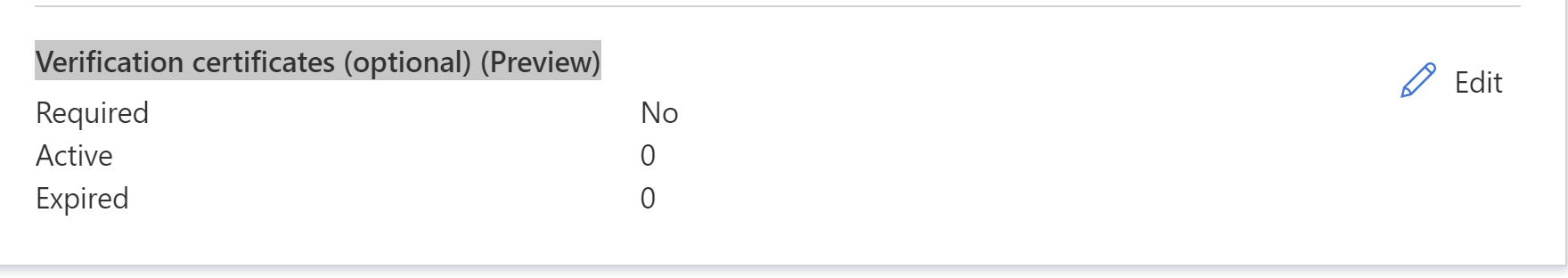

- Click on Single sign-on blade and then look at "Verification certificates (optional) (Preview)" on the right pane.
- Confirm if the certificate uploaded is the correct one.
