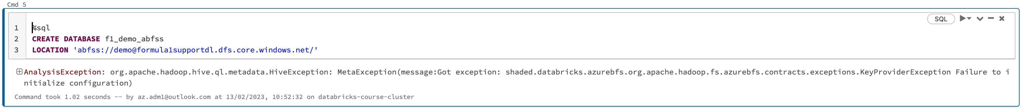

Hi Team, I am creating a database in Azure Databricks using the abfss location in the create table statement and it throws an exception.
  • Authentication to ADLS - Session Scoped Access Key Authentication as below
  • Access Method to ADLS - abfs driver as below
spark.conf.set("fs.azure.account.key.formula1supportdl.dfs.core.windows.net",
                dbutils.secrets.get(scope="databricks-support-scope", key="formula1supportdl-account-key"))

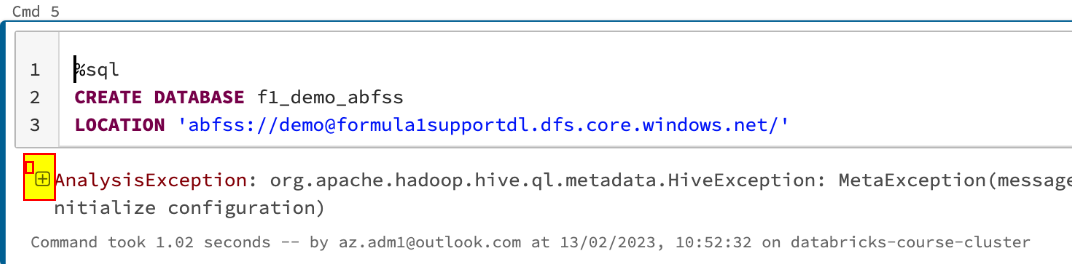

%sql
CREATE DATABASE f1_demo_abfss
LOCATION 'abfss://******@formula1supportdl.dfs.core.windows.net/'
Error message as below

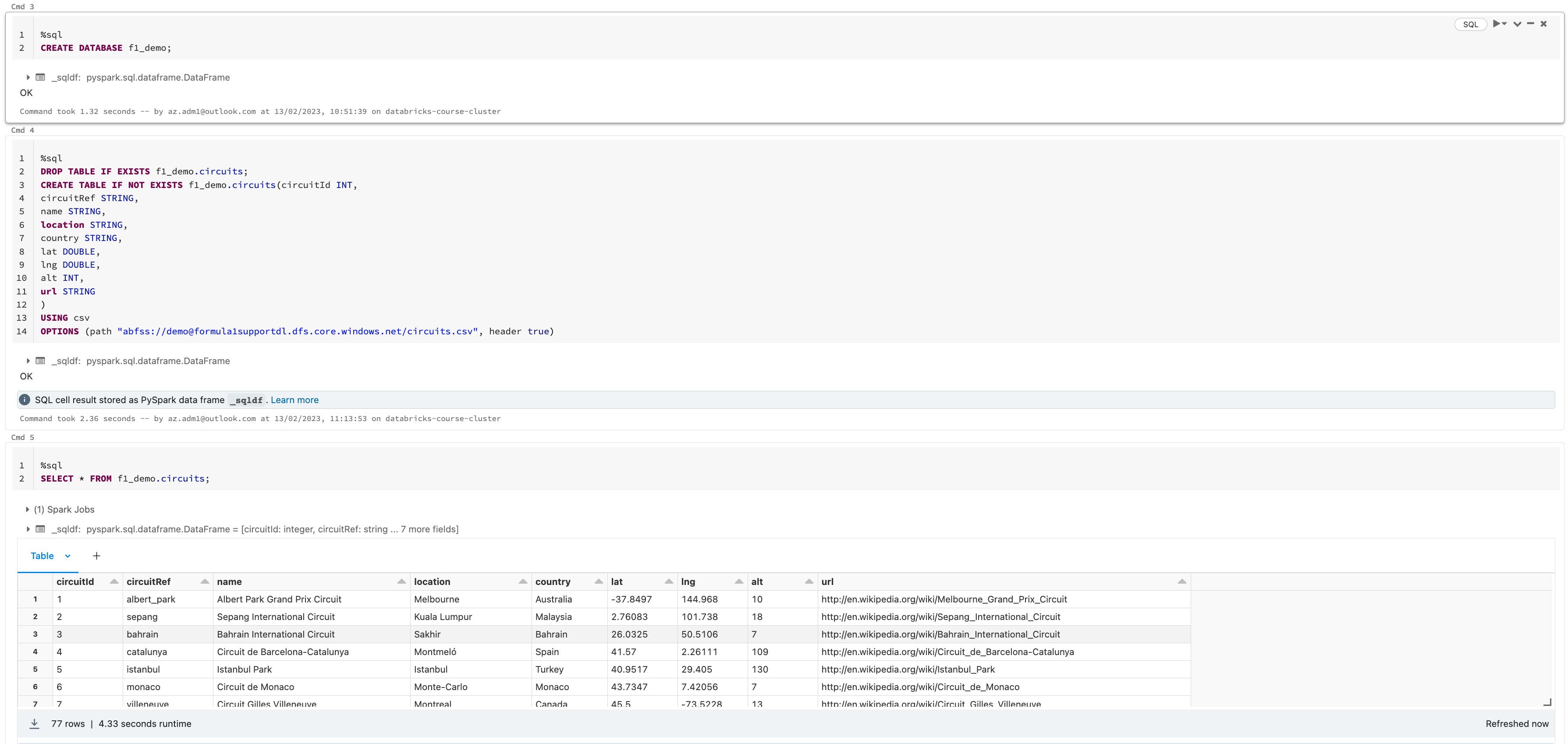

  • Access to the same storage account/ container works perfectly fine if I use the cluster scoped authentication. i.e., when adding the spark configuration to the cluster configuration instead of the using in the notebook.
  • Specifying the location for a table as above works perfectly fine too. This is only for a problem in create database statement.
Example CREATE TABLE with the same location works perfectly fine as below
Screenshot 2023-02-13 at 11.14.53
As this is only a problem when trying to access the location on CREATE DATABASE statement using session scoped authentication, it seem to be a bug. As I said about cluster scoped authentication works perfectly fine. Also, CREATE TABLE with the same location works perfectly fine.
