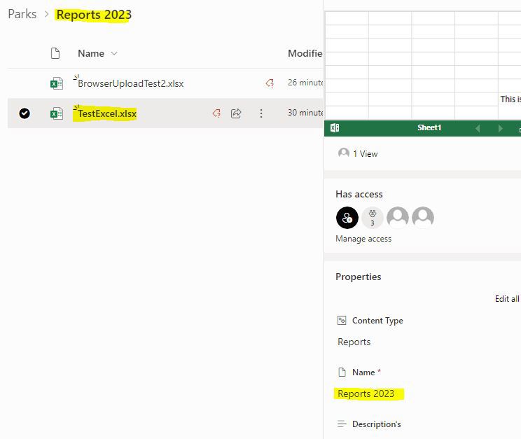

When we upload a document to a Doc Set, we can n longer apply the correct Content type. When viewing the Document Info, we can see the Document Set info.
This has only started last month.
DS_CT_Error
The Only fix we've found is to change the Document Set content type from report to Folder.

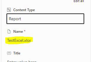

DS_CT_Error2
After this we can edit the Documents info and assign the correct content type

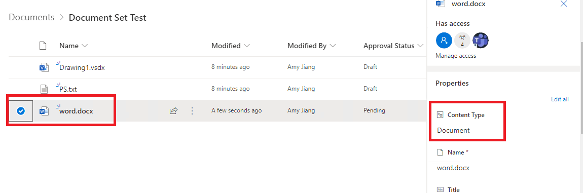

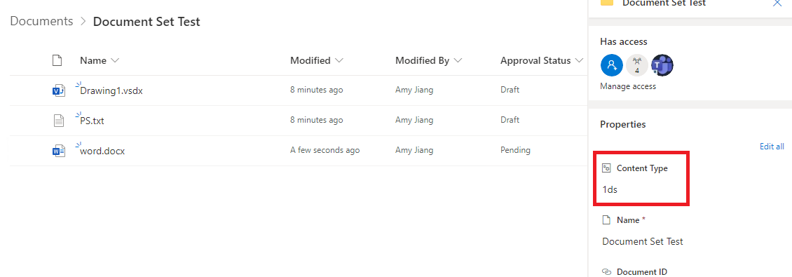

    I tested it in my environment and it works fine without reproducing your issue.
    02151
    02153
    02154
    According to your description, you said that only one of the three document sets in this Folder can work well.
