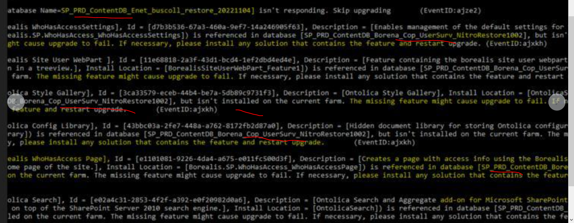

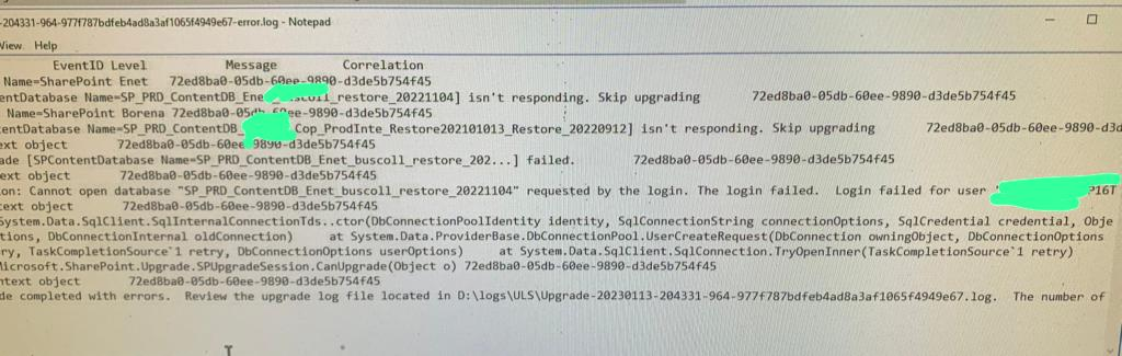

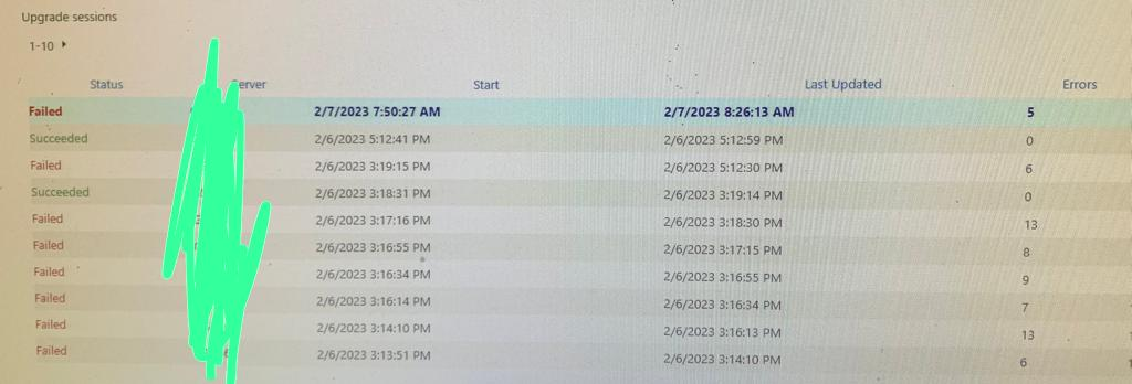

After patching while running product config wizard is failing , with the following errors:
Here is the CU version we have and failed at the product config wizard step:
and showing config database version also same: 16.0.5378.1000 from servers in farm section

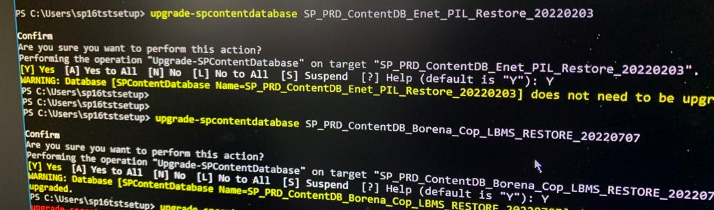

We tried to upgrade content database with powershell that is also failing.
When we click on review database status it is keep on loading the page but not taking anywhere even it is for very long hours.
whatever server in the above marked it is same server top to bottom.
Please suggest what needs to be done. thank you

    According to the information in the log, the problem should be that the operating account does not have the permission of the database. Any SharePoint service account that needs to access the SQL database needs Security Administrator and DBCreator permissions on the SharePoint related database.
    Please refer to this post to check whether the account have permission.
    Removing the missing features from the farm in SharePoint 2016
    In your SharePoint Server, Open Windows PowerShell as Administrator and run the below PowerShell script to remove all missing features from your farm:
    Add-PSSnapin Microsoft.SharePoint.PowerShell
    function Remove-SPFeatureFromContentDB($ContentDb, $FeatureId, [switch]$ReportOnly){
        $db = Get-SPDatabase | where { $_.Name -eq $ContentDb }
        [bool]$report = $false
         if ($ReportOnly) { $report = $true }
         $db.Sites | ForEach-Object {
              Remove-SPFeature -obj $_ -objName "site collection" -featId $FeatureId -report $report
             $_ | Get-SPWeb -Limit all | ForEach-Object {
                Remove-SPFeature -obj $_ -objName "site" -featId $FeatureId -report $report
    function Remove-SPFeature($obj, $objName, $featId, [bool]$report){
      $feature = $obj.Features[$featId]
       if ($feature -ne $null) {
         if ($report) {
          write-host "Feature found in" $objName ":" $obj.Url -foregroundcolor Red
       else{
          try {
            $obj.Features.Remove($feature.DefinitionId, $true)
             write-host "Feature successfully removed from" $objName ":" $obj.Url -foregroundcolor Red
          catch {
         write-host "There has been an error trying to remove the feature:" $_
    else {
    #write-host "Feature ID specified does not exist in" $objName ":" $obj.Url
    Remove-SPFeatureFromContentDB -ContentDB "Your Content DB Name" -FeatureId "e9728ee6-7bfc-40a1-ad72-aa9a57e14407"
    Fix the Content Database Version Mismatch
    Again run the SharePoint 2016 PowerShell as Administrator, and run the below command line to update the content database schema.
    Get-SPContentDatabase | Upgrade-SPContentDatabase
    Try now to run the SharePoint Configuration wizard which should be completed successfully.
