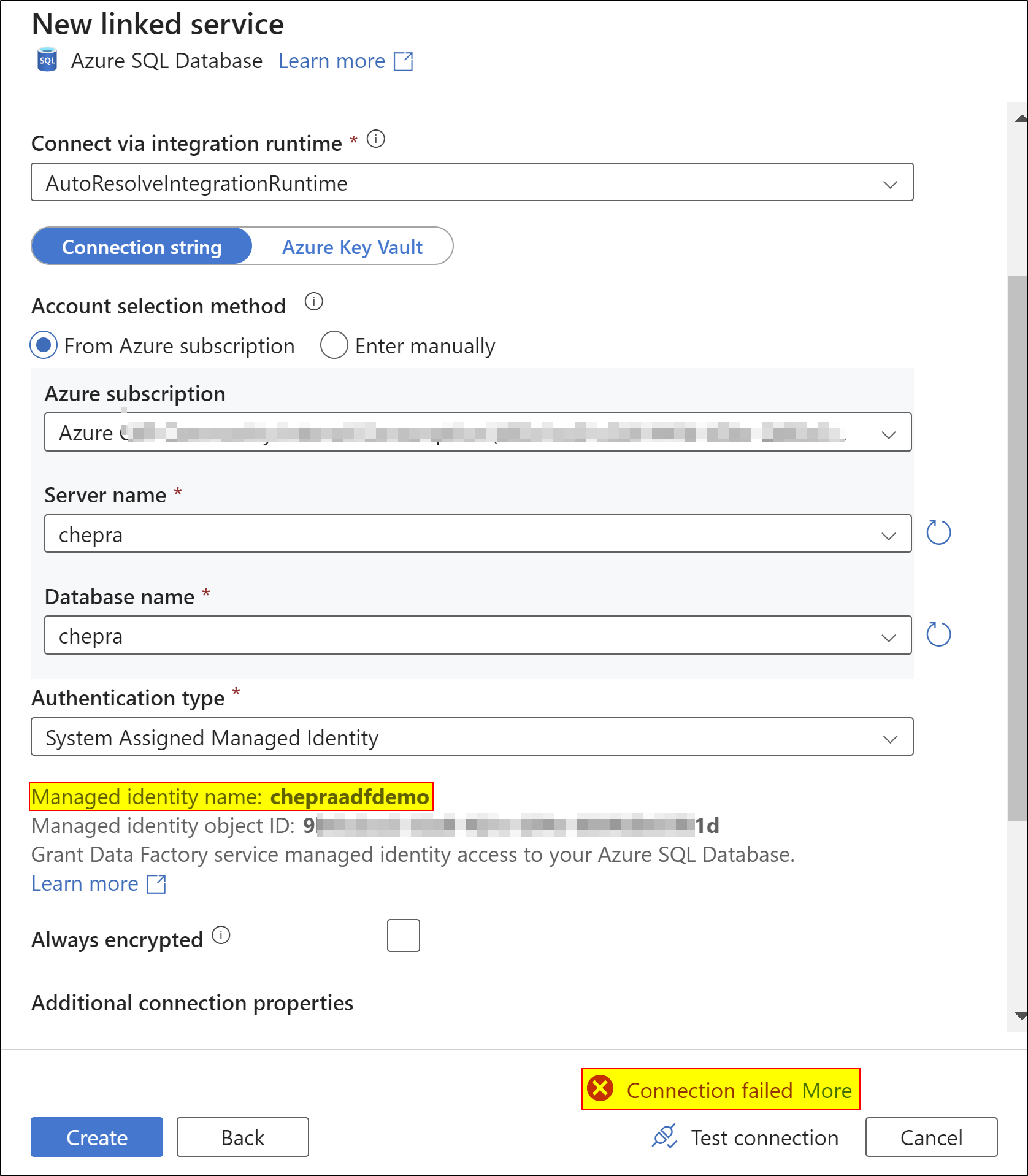

    As per the repo - I tried to use system-assingned managed identity authentication to connect Azure SQL Database.
    Step1: Create Azure SQL Database linked service with Authentication type: System Assigned Managed Identity
    Note: Tried to connect without granting permission, where result is connection failed.

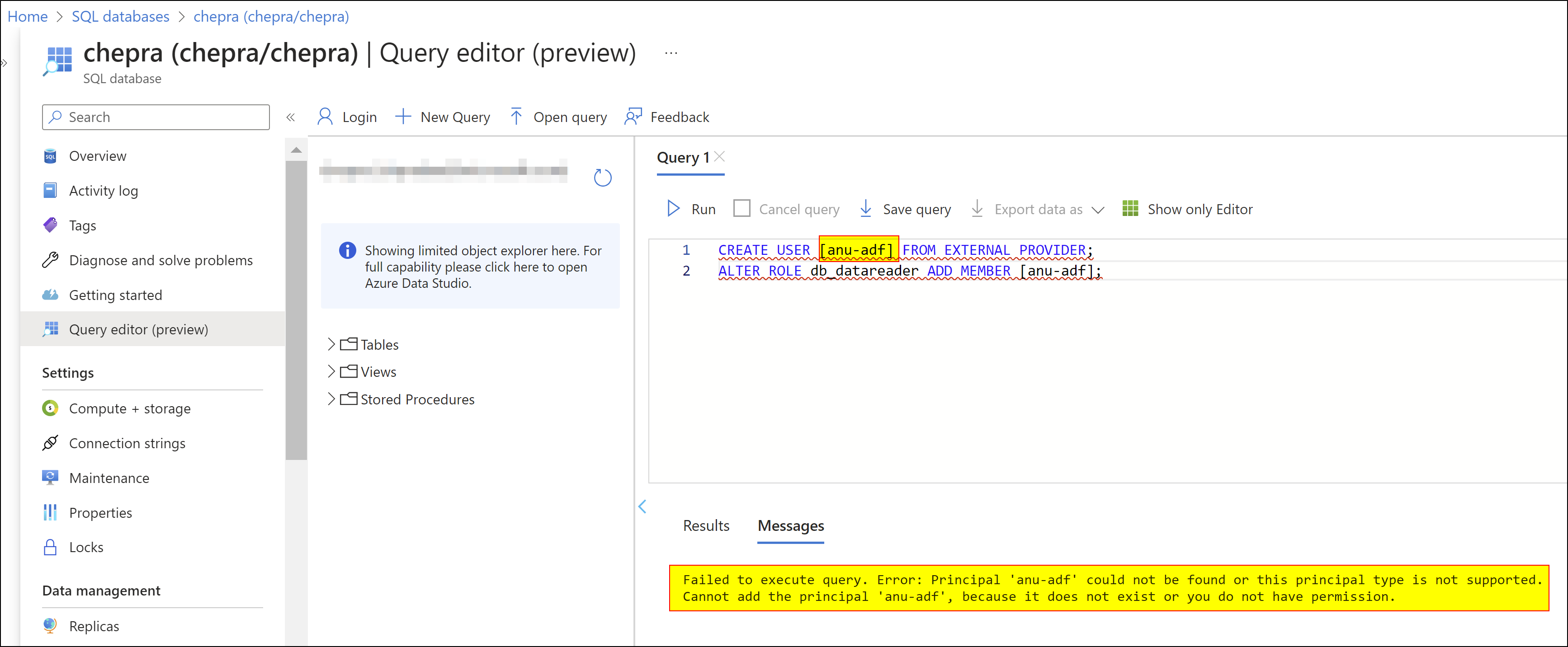

    Step2: To grant permission to the managed identity name copy the managed identity name chepraadfdemo as shown in step1.
    Step3: Go to Azure SQL Database => Query Editor => login as Active Directoty authentication as shown below:
    Step4: Grant permission to the managed identity by using the below SQL query:
    CREATE USER [your Data Factory name] FROM EXTERNAL PROVIDER;
    ALTER ROLE db_datareader ADD MEMBER [your Data Factory name];
    Step5: Now test connection of the Azure SQL database linked service.
    By following the above steps, we had successfully connected Azure SQL Database using System-assigned managed identity authentication.
