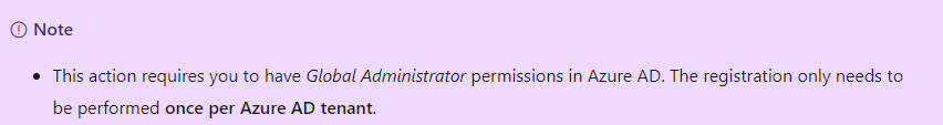

    The Global Administrator permissions requirement is missing in the Azure CDN doc (I will try to get it added) but you can see this requirement in the Azure Front Door doc which uses the same ApplicationId.
    Azure CDN doc: https://learn.microsoft.com/en-us/azure/cdn/cdn-custom-ssl?toc=%2Fazure%2Ffrontdoor%2FTOC.json&tabs=option-2-enable-https-with-your-own-certificate#register-azure-cdn
    Azure Front Door doc: https://learn.microsoft.com/en-us/azure/frontdoor/standard-premium/how-to-configure-https-custom-domain?tabs=powershell#register-azure-front-door
    I would request you to make sure that your Azure Key Vault account is under the same subscription as your Azure CDN profile & CDN endpoints that you want to enable custom HTTPS on. And when trying to register the Azure CDN as an app in your Azure Active Directory via PowerShell, make sure that you have Global Administrator permissions in Azure AD.
