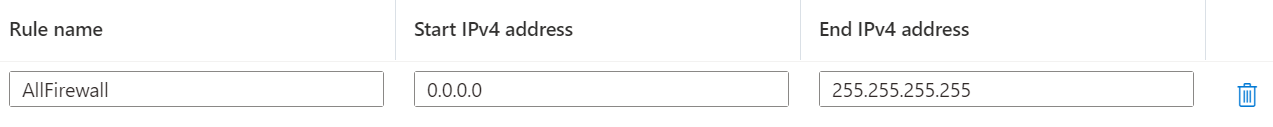

I have created a sample database in azure cloud using azure sql database using single database approach.
Now issue is the particular database is not able to access through Azure VM or other machines but able to access through my local machine . For this i have set the fire wall rule to allow the access to all from start ip 0.0.0.0 to end ip 255.255.255.255 but still the azure Vm is not able to access the DB . Kindly let me know what is the mistake i am doing or any help is grateful .
