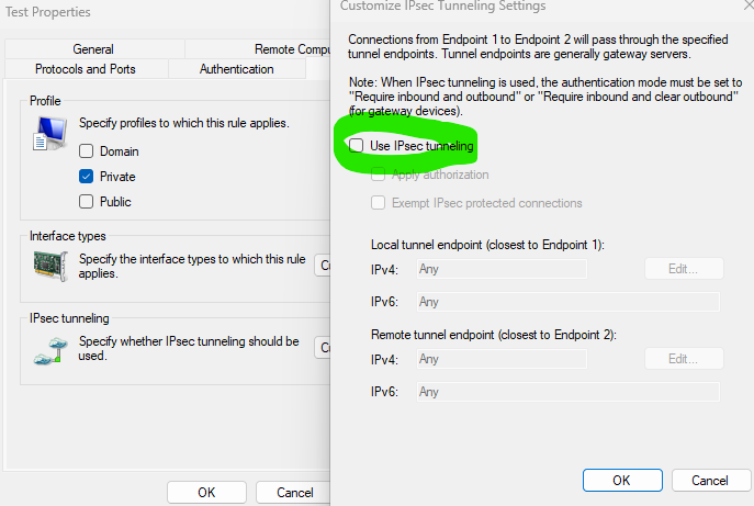

    Surely IPSec is optional. If not, why is it offered as a checkbox? And also, I was able to connect client to PDC without it. And MainMode and QuickMode shows traffic.

    OK. I get it. Just like TCPIP4 in Network Adapter Properties is a checkbox, which allows you to uncheck it, it is a required item always. So IPSEC is required.
