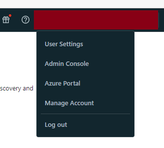

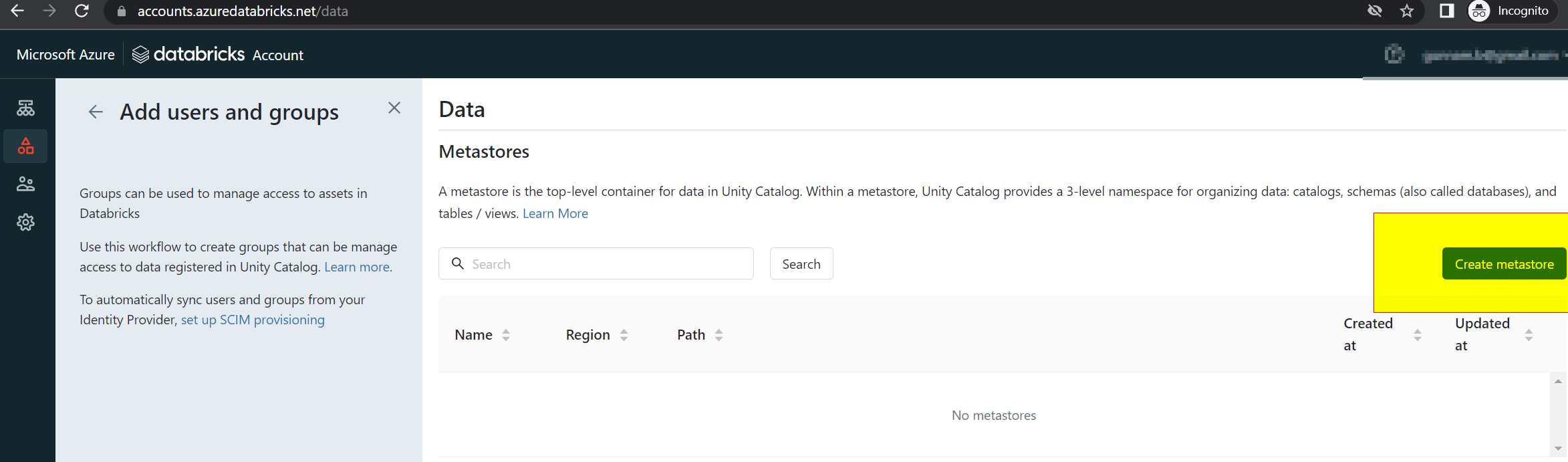

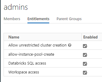

I want to configure Unity Catalog and one step is creating a metastore in the region where I create databricks workspace.

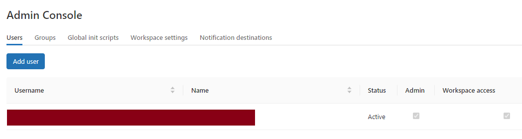

I created a workspace with a premium pricing tier and I am the admin.

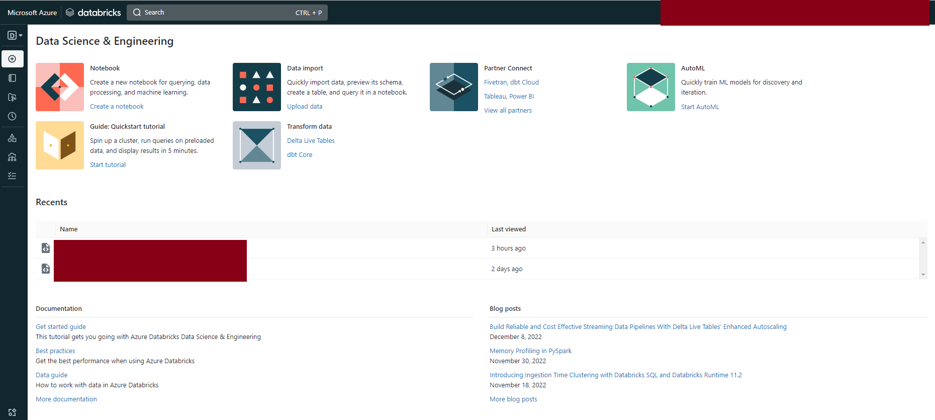

Following the documentation, I should go to the Data tab to create metastore.
However, when I open the Data tab, I don't see "Create Metastore" button.
The same in SQL persona:
Could you guide me how to make a new metastore?

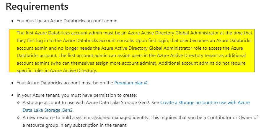

    You must be an Azure Databricks account admin to getting started using Unity Catalog this can be done for first time using Azure Active Directory Global Administrator of your subscription.
    The first Azure Databricks account admin must be an Azure Active Directory Global Administrator at the time that they first log in to the Azure Databricks account console. Upon first login, that user becomes an Azure Databricks account admin and no longer needs the Azure Active Directory Global Administrator role to access the Azure Databricks account. The first account admin can assign users in the Azure Active Directory tenant as additional account admins (who can themselves assign more account admins). Additional account admins do not require specific roles in Azure Active Directory.
    How to identify your Microsoft Azure global administrators for your subscriptions?
    The global administrator has access to all administrative features. By default, the person who signs up for an Azure subscription is assigned the global administrator role for the directory. Only global administrators can assign other administrator roles.
    Login into the Azure Databricks account console via Global admin and then account admin can assign users in the Azure Active Directory tenant .
    For more details, refer to Azure Databricks - Get started using Unity Catalog and also refer to MS Q&A thread - How to access Azure Databricks account admin? addressing similar issue.

  1. Bhargava-MSFT 31,361 Reputation points Microsoft Employee Moderator
    2023-02-21T02:13:07.5+00:00
    Hello @Mohammad Saber,
    Welcome to the MS Q&A platform.

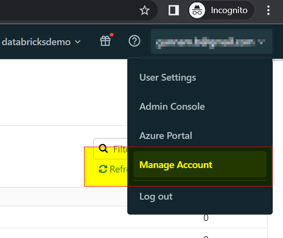

    The reason for not seeing the "Create metastore" button is that you are not an AAD global admin or a Databricks admin in the account console.

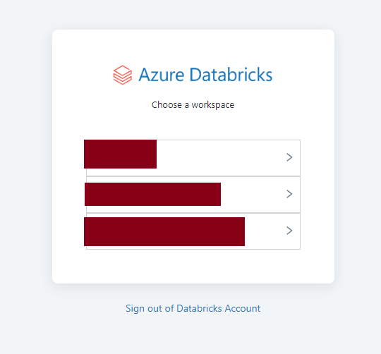

    And can you please check from the new Azure Databricks account management login portal using the below URL?
    https://accounts.azuredatabricks.net/login/
