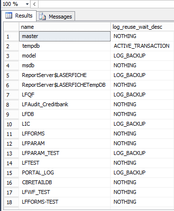

    In simple recov mode it's should work to shrink the log file, but there could be some causes that prevents that, so check first the log reuse state with
    select name, log_reuse_wait_desc
    from sys.databases

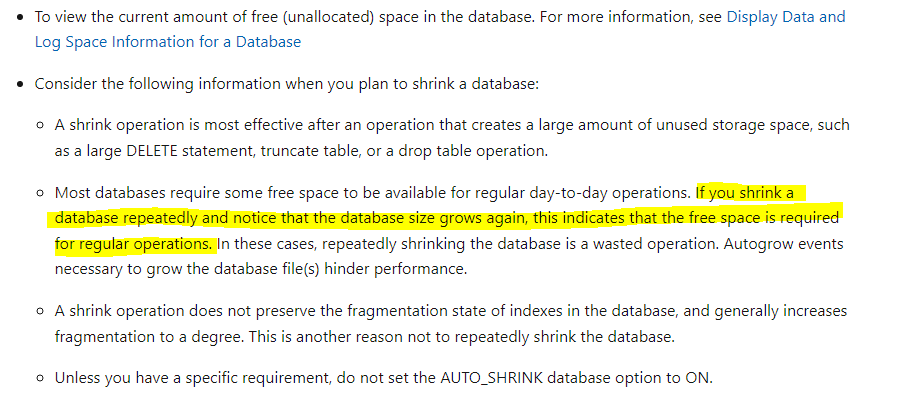

    Before you start to shrink files, you need to have an understanding which size of the log file the workload requires. If you shrink below that limit, they will only grow again. And growing log files takes resources, as the newly allocated spaces needs to be zeroed out.
    I would not say that 12 GB is particularly big, but obviously this needs to be put in relation to the size of the data file()s).
