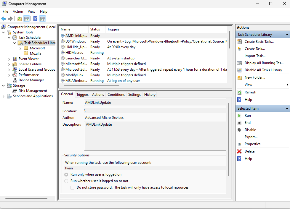

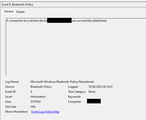

I use a Bluetooth device paired with software specifically for it. I have already created a custom task to run the software and bypass the UAC prompt by having it run at the highest privileges. and created a shortcut for it. Those work without issue. I now want to automate the software starting when I connect the device. I have used Event Viewer to find the Log Name, Source, and Event ID, which I then entered in the trigger. It will not work, however.

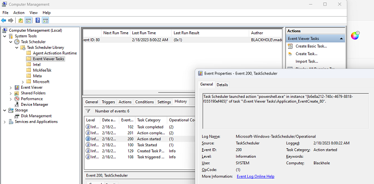

    What specifically doesn't work? Does the task scheduler not launch the task? Or does the program you execute fail to launch the software?
    Verify that you have enabled task history. If you see the option to disable the history, then you have it enabled.
    Is the task set to execute as your account and do you have it set to "run only when the user is logged on"?
    What program does the task run? If the task scheduler is launching the task, then you need to capture the output of whatever program you are running. Create a bat file that executes your program. Echo %date% %time% as the first and last line the .bat so that know when the task starts and ends.

    The software is DS4Windows. I did not have task history enabled, I have enabled it now. However, I am not seeing all the same
    things you are.
    Screenshot_20230218_162308
    It was set to only run when user is logged on, yes. I can't et it to run otherwise so far.
