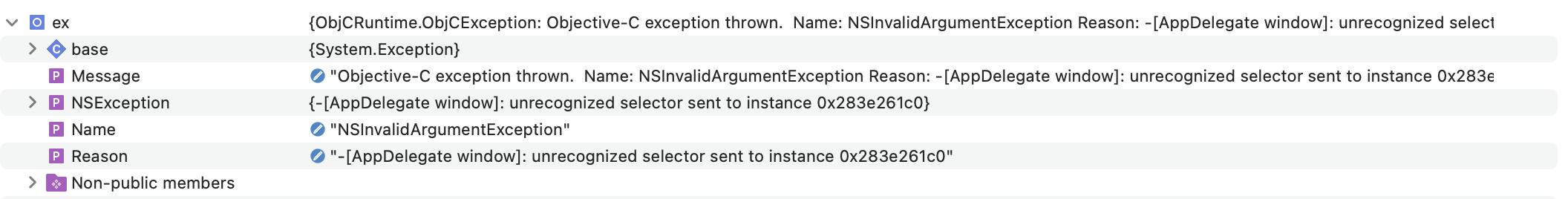

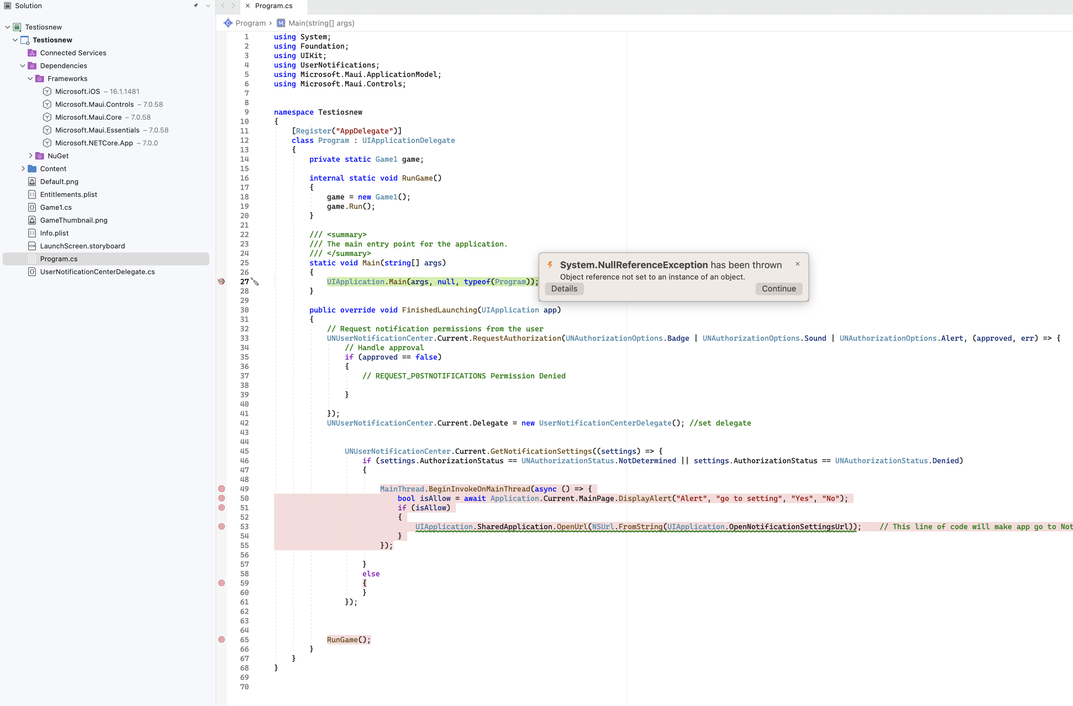

    In Program.cs, I don't get the error 'InvokeOnMainThread' but I always get an exception when I use the code in public override void FinishedLaunching:
    It means that RootViewController is null. I'm not sure how you set you set the MainPage in your project. In the previous comment, you said it crashed at this line (bool isAllow = await App.Current.MainPage.DisplayAlert("Alert", "go to setting","Yes","No"); ), you can check if there is not a MainPage, then show the alert on the same page where the button is.
