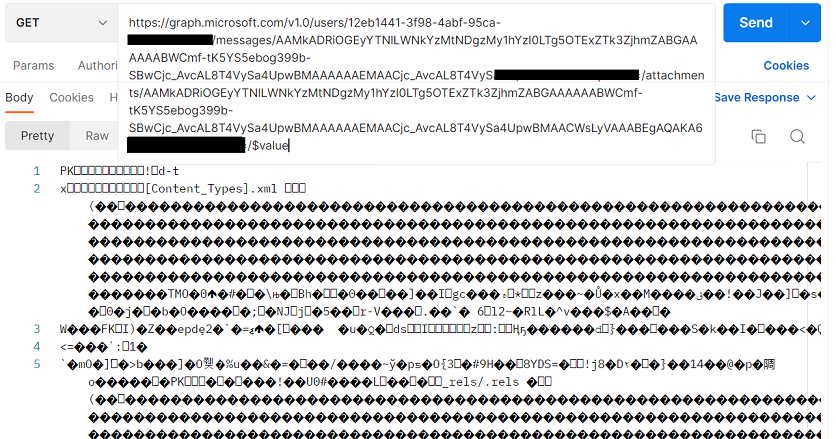

    This GET /users/{id}/messages/{id}/$value Graph API will give you MIME content of message with header. If you want to get the content of attachment you need to use GET /users/{id | userPrincipalName}/messages/{id}/attachments/{id}/$value this Graph API endpoint. This will give you raw contents of an attachment that is attached to a user message. Please refer to the below sample screenshot.1
    Please refer to this documentation for more details.
