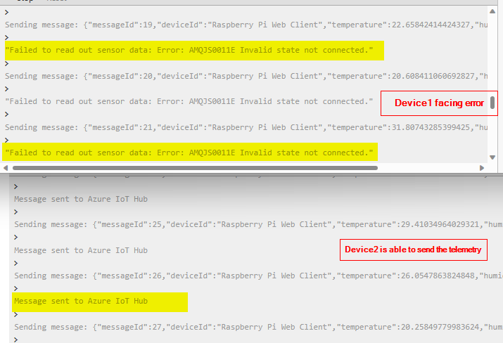

    Below is a sample test when 2 devices are simultaneously using the same device connection string to send the telemetry!!!
    Apart from sending telemetry issues, we may see the below errors during provisioning and Authentication process.
    DeviceIdentityConflict: This error occurs when you try to register a device identity that is already in use by another device. This error may be thrown when you try to register a new device or when you try to connect an existing device to the IoT hub.
    DeviceAlreadyExists: This error occurs when you try to create a new device identity with a name that is already in use. This error may be thrown when you try to register a new device using a connection string that is already associated with another device.
    Unauthorized: This error occurs when the device authentication credentials (such as the device key or SAS token) provided in the connection string are not valid for the device identity associated with that connection string. This error may be thrown when you try to connect a device using a connection string that is already associated with another device.
