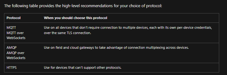

    For more details, please see Communicate with your IoT hub using the MQTT protocol and Choose a device communication protocol.
