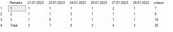

    I used a CTE where the columns were summed first. You can try this query.
    ;with CTE as(
      select *,[21-01-2023] + [23-01-2023] + [24-01-2023] +
      [25-01-2023] + [27-01-2023] + [28-01-2023] as colsum from #temp3)
    select isnull (cast(remarks as varchar),'Total') as Remarks,
    sum(case [21-01-2023] when [21-01-2023] then [21-01-2023] end ) as [21-01-2023],
    sum(case [23-01-2023] when [23-01-2023] then [23-01-2023] end ) as [23-01-2023],
    sum(case [24-01-2023] when [24-01-2023] then [24-01-2023] end ) as [24-01-2023],
    sum(case [25-01-2023] when [25-01-2023] then [25-01-2023] end ) as [25-01-2023],
    sum(case [27-01-2023] when [27-01-2023] then [27-01-2023] end ) as [27-01-2023],
    sum(case [28-01-2023] when [28-01-2023] then [28-01-2023] end ) as [28-01-2023],
    sum(case colsum when colsum then colsum end ) as colsum
    from CTE group by grouping sets (remarks,());
    The final result of the test:
    Best regards,
    Percy Tang
