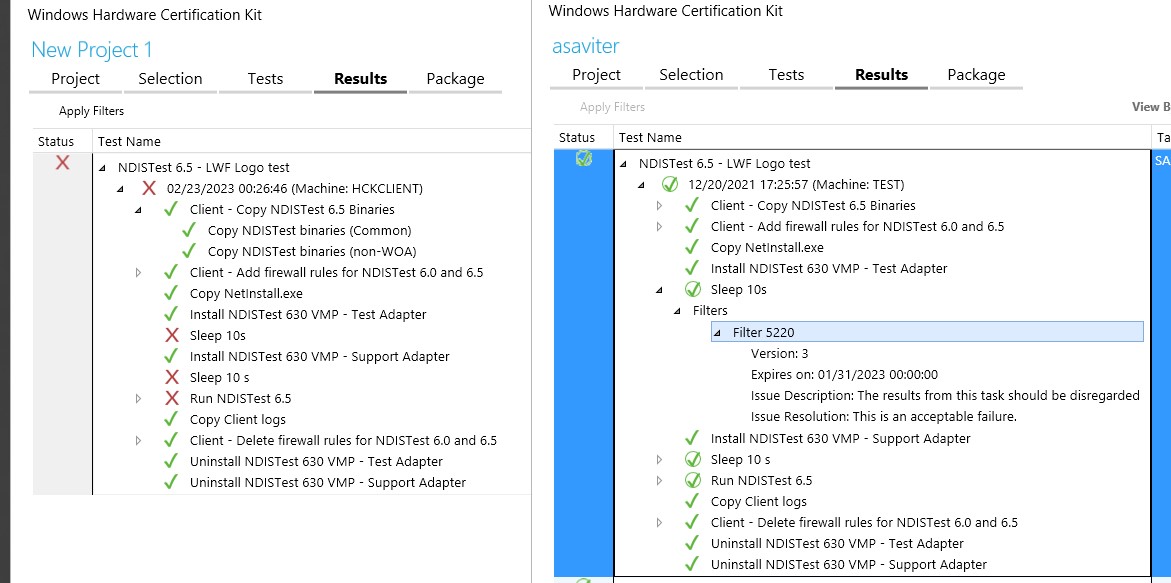

I think i have just found the crux of the problem.
The problem is that HCK Filter has not update id: 5220 filter expire time. Last expire time is 2023/1/31.(today is 2023/2/24)
How to notify Microsoft staff to update id:5220 Filter?
Filters : https://partner.microsoft.com/zh-cn/dashboard/hardware/dtmfilters
The driver was tested two years ago and this year, but the error is different.
This is HCK test result:Dingtalk_20230223163053
Left is today.right is two years ago.
Strangely, the result on the right “sleep 10s” task is error but it's ignore.
Filter 5220
	Version: 3
	Expires on: 01/31/2023 00:00:00
	Issue Description: The results from this task should be disregarded.
	Issue Resolution: This is an acceptable failure.
Dingtalk_20230223164209

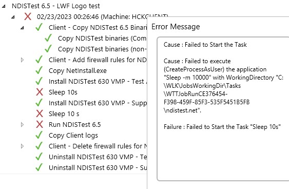

Cause : Failed to Start the Task
Cause : Failed to execute(CreateProcessAsUser) the application "Sleep -m 10000" with WorkingDirectory "C:\WLK\JobsWorkingDir\Tasks\WTTJobRunCE376454-F398-459F-85F3-535F5451B5FB\ndistest.net".
Failure : Failed to Start the Task "Sleep 10s"
Any suggestions to get past this?
