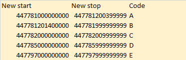

I have a list of numbers as below. I have to go through all the numbers listed below
and try to see if they are between the new start and new stop and the answer would be the code
ex 447797704123000 would be E
452591880100000 - Not found
etc

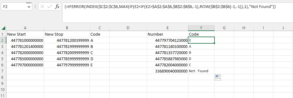

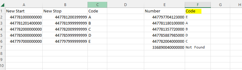

    According to your description and the sample, I make a simple sample like following image.
    Capture54
    Then please enter formula =IFERROR(INDEX($C$2:$C$6,MAX(IF(E2<IF(E2>$A$2:$A$6,$B$2:$B$6,-1),ROW($B$2:$B$6)-1,-1)),1),"Not Found") in F2.
    Press Ctrl + Shift + Enter to make this formula as an arry formula.
