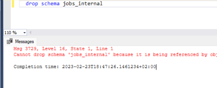

I'm trying to export the database and receive the following error:
One or more unsupported elements were found in the schema used as part of a data package. Error SQL71501: Error validating element [jobs_internal]: Schema: [jobs_internal] has an unresolved reference to object [##MS_JobAccount##].

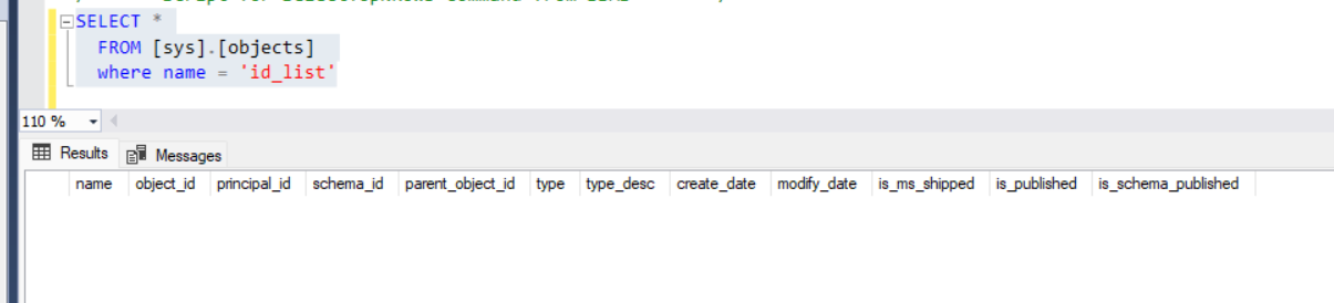

I've tried to delete all that is related to [jobs_internal] schema, but there is one object that exists 'id_list' that I can not delete and locate. Selecting from objects returns no results. Drop schema returns an error.
Screenshot 2023-02-23 190448
Screenshot 2023-02-23 190752
SELECT *
  FROM [sys].[objects]
  where name = 'id_list'
drop schema jobs_internal

    That is what helped me to restore db without deleting jobs_internal schema:
      ALTER AUTHORIZATION ON Schema::[jobs_internal] TO [dbo]
