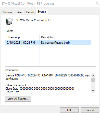

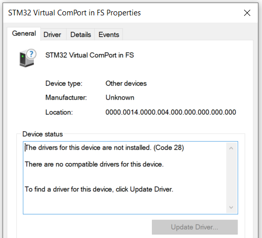

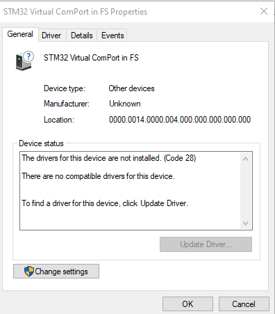

Hello, I currently have an stm32 project that uses usb cdc ecm to transfer data. Currently, when I plug the cable (from STM32 USB device) into the computer, it does not recognize the CDC-ECM device in other devices, rather labelling it as an STM32 Virutal ComPort in FS.
I have tried changing the VID and PID (I was using the ECM ones from the android ether library) back to default STM32H7 ones. Additionally, I have tried changing device class and subclass values in usb device descriptor file to 0x02 as recommended on the Microsoft site for usbser.sys on Windows 10 and see additional events for the port. However, none of these have solved the issue, and I still see 'Code 28'. The Update Drive option is also greyed out for me.

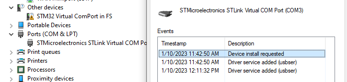

Additionally, the STLink Virtual COM Port is showing that it is using the usbser driver successfully, so I'm not sure why the actual board is not doing the same.
Is there a driver install that needs to be done or a setting to change for this?
Thank you.
