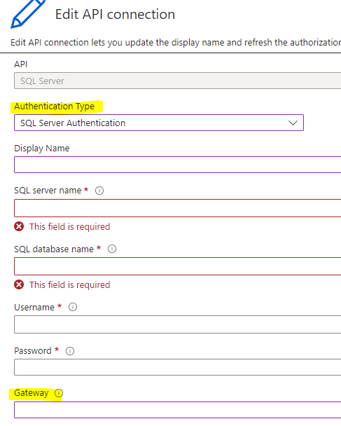

    @Josh Thanks for reaching out. Your resource type Microsoft.Web/connections is missing authType value for the SQL connection.

                 "authType":"basic"
    Your $connection looks good as below:
