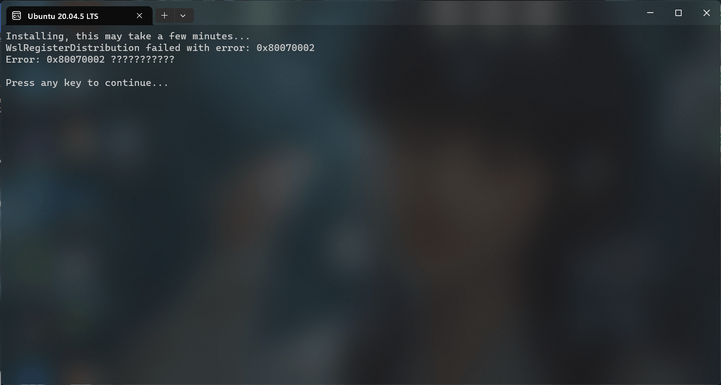

An error code occurred when installing the Linux subsystem:WslRegisterDistribution failed with error: 0x80070002
I have installed the Ubuntu subsystem before, and there is no problem with it. However, when I tried to access wsl using Windows terminal today, I found that I could not access it and reported an error that the path could not be found. Then I found that the wsl2 I installed could not be found. I tried to reinstall it, but it could not be installed.
  • Windows subsystem for Linux is enabled
  • Virtual machine feature enabled
  • Downloaded Linux kernel update package

    WSLRegisterDistribution Failed error can occur due to a corrupt Linux installation or if the Linux subsystem is disabled.
    Restarting the LxssManager Service might help in resolving this issue. Linux instance life cycle service i.e. LxssManager operates in the background to keep things under control.
    On the services find and restart the LxssManager service.
    Also, check if the Windows Subsystem for Linux feature is turned off if so try turning it on and rebooting the device.

    I am still facing issue
    C:\Windows\System32>wsl --install
    Installing: Ubuntu
    Ubuntu has been installed.
    Launching Ubuntu...
    Installing, this may take a few minutes...
    Error: 0x80070002 The system cannot find the file specified.
    WSL is enabled
    Virtual Machine platform enabled
    Hypervisor Platform disabled
    LxssManager started manually
    Downloaded in Ubuntu but facing above issue
