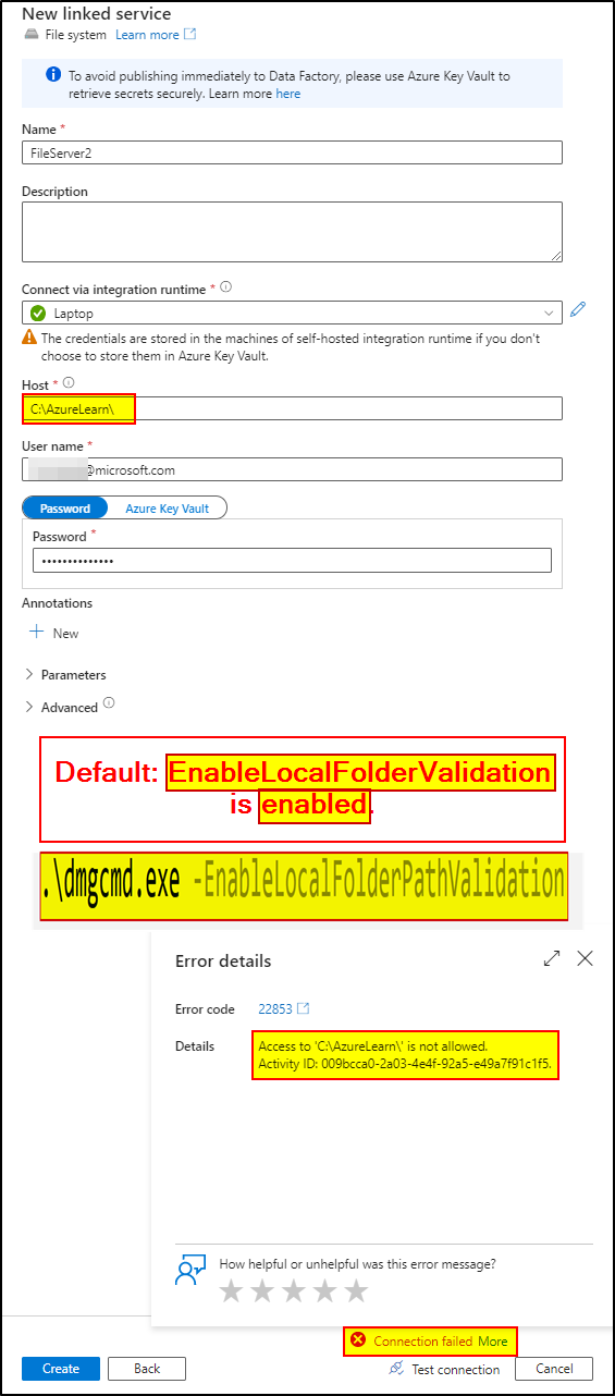

Access to C:\Data not allowed . Error Code 22853
Sushan 0 Reputation points
2023-02-24T07:06:54.58+00:00
Any workway around this ?

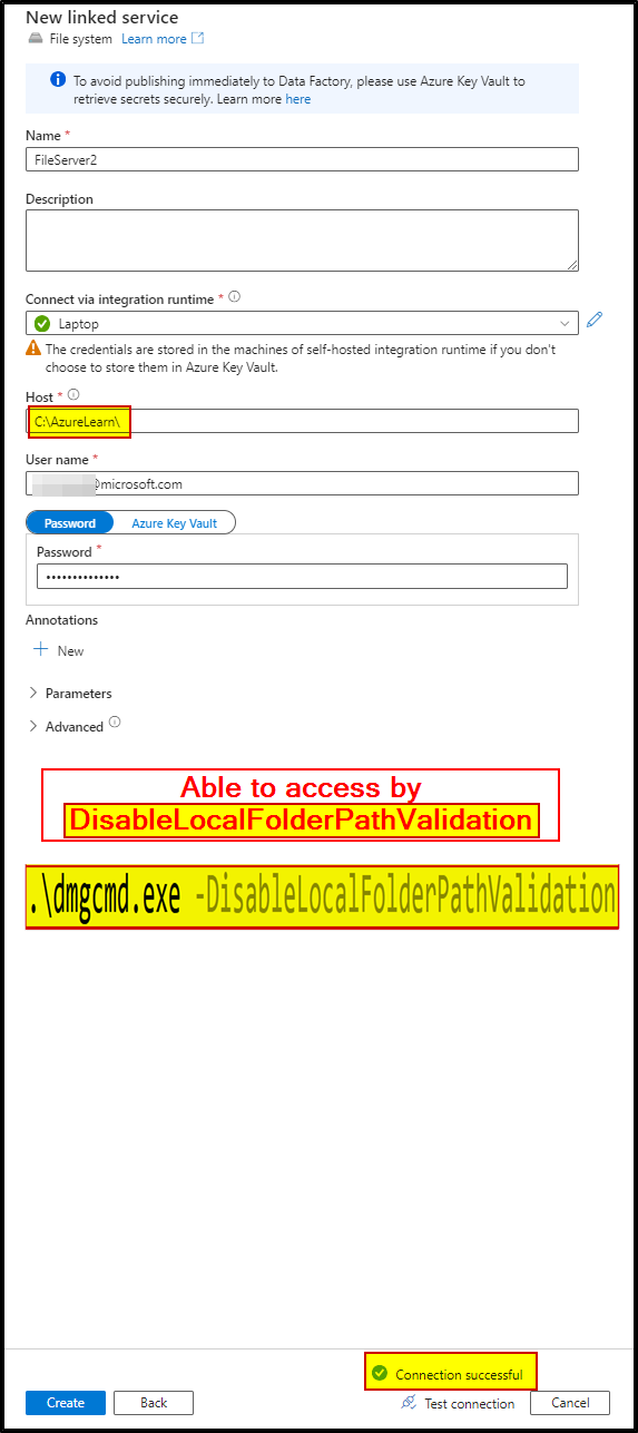

    According to the offical documentation, the latest SHIR has a security fix that has been changed and does not allow access to local files by default.
    You must run .\dmgcmd.exe -DisableLocalFolderPathValidation to disable the setting for more details, refer to Set up an existing self-hosted IR via local PowerShell
    Default: Enable security validation to disable access to file system of the local machine.
    Errorcode22853
    After Disabling access to file system of the local machine using: .\dmgcmd.exe -DisableLocalFolderPathValidation able to access the data from linked service.
