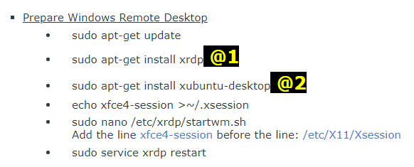

    The following step by step list, I wrote for myself to help me before lecture to do it fast. It provide information on installing SQL Server on linux and on the way it provide the way to use RDP as one of the first steps. It should help if you are looking for short-direct-step by step:
    https://ariely.info/Blog/SQLServeronLinux/tabid/182/language/he-IL/Default.aspx
    The short answer is in the screenshot bellow which is taken from the link I mentioned above:
    For more information and other steps check the link 😀
