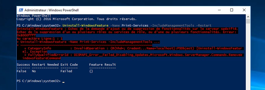

on a fresh installed WSE16, I'm stuck with a role impossible to delete.
The one concerned is Print-Scan-Server only (all others are working fine and able to be added or deleted)
Have tried with server manager first, then it hang up at 58%
Then tried with Powershell same hang at 60%
erreur suppression role

    You can also try a repair install by running setup.exe from the root of the install media but time may be better spent standing up a new one, patch fully, migrate roles over and move on.
