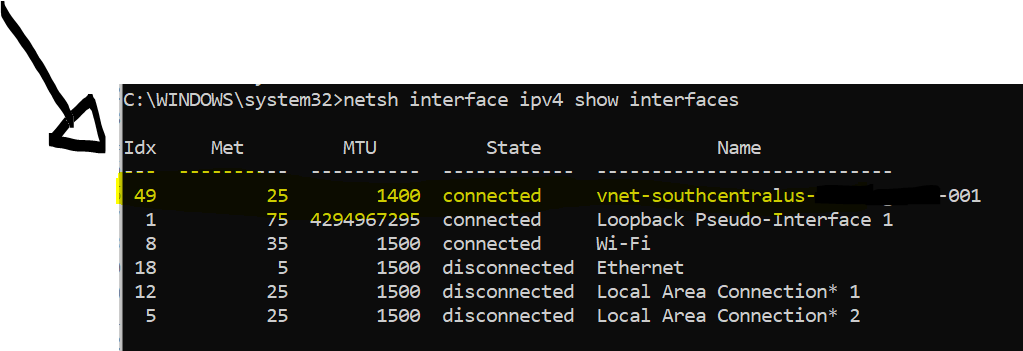

    1-For instance, I have faced the same issue with latency as well. On the output, you will see that I have a P2S VPN and I found that the MTU value configured is not the standard which is 1500.
    Adapter info below:
    PPP adapter vnet-southcentralus-xxxxx-xxx-001:
       Connection-specific DNS Suffix  . :
       IPv4 Address. . . . . . . . . . . : 192.168.254.2
       Subnet Mask . . . . . . . . . . . : 255.255.255.255
       Default Gateway . . . . . . . . . :
    2-Then, you can look at the MTU value:
    3- As per public documentation, there is a default behavior that is relevant to know which is:
    • All data packets will be fragmented at 1400 as MTU value permitted.
    • If on TCP session is observed TCP-Out-of-Orders packets sequence, Port Reused behavior and so on... Well, they will be dropped.
    • If you want to enhance or speed up your data session, you can either use an NVA (Network Virtual Appliance) or work on the MSS value on TCP sessions.
    • You can modify the MTU value along the routing path.
    • Please direct your self to the following URL: https://learn.microsoft.com/en-us/azure/virtual-network/virtual-network-tcpip-performance-tuning
    • You can change the listening ports and among others.
    • Furthermore, review the MTU value at the OS level on your server/vm.
    • Finally, you can reset the VPN gateway and get better results with your latency concern.
