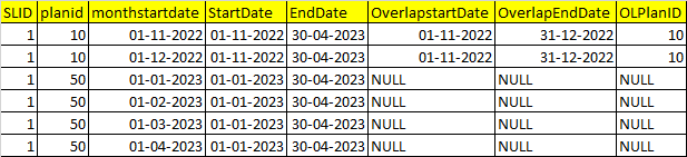

Hi @Erland Sommarskog ,
Problem Statement: If partially overlap then return till the next plan and incase of fully overlap then return maxplanid.
Input data is having all the required information just we have to limit no of records based on the condition. I tried myself but didn't get exected results.
Case 1: If plan is partially overlap then return the records between that overlap start and Overlapend date
For Example: Planid : 10 is partially overlap so we need to return Nov and dec because new planid :20 has released from jan-2023.
Case 2: If plan is Fully overlap then return the max plan id records between that overlap start and Overlapend date
For Example: Planid :20,30,40,50 are the fully overlap plans then need to return only max planid :50 records from jan,feb,mar,apr-2023.

  • Output

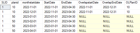

  1. LiHongMSFT-4306 31,616 Reputation points
    2023-02-27T02:41:55.7433333+00:00
    Hi @Sahoo
    One thing I am confused is that you say '50' is the fully overlap plan, however, the OverlapStartdate and OverlapEnddate of '50' is NULL in your table.
    Please check this query:
    ;WITH CTE AS
     SELECT SLID,planid,monthstartdate,StartDate,EndDate,OverlapstartDate,OverlapEndDate,OLPlanID
           ,DENSE_RANK()OVER(ORDER BY planid DESC) AS RNum
     FROM #target
     WHERE (monthstartdate BETWEEN StartDate AND EndDate)
       AND ((StartDate = OverlapstartDate AND EndDate = OverlapEndDate) OR OverlapEndDate IS NULL)
    FROM CTE WHERE RNum = 1
    UNION
    FROM #target
    WHERE (monthstartdate BETWEEN OverlapstartDate AND OverlapEndDate) AND EndDate <> OverlapEndDate
    Output:
    Best regards,
    Cosmog Hong
    Note: Please follow the steps in our Documentation to enable e-mail notifications if you want to receive the related email notification for this thread.

  1. Erland Sommarskog 128.9K Reputation points MVP Volunteer Moderator
    2023-02-26T22:25:31.4666667+00:00
    I will have to admit that there is much here I don't understand. Specifically, I don't know anything about the actual business, so for me these SLID, planid, OverlapStart etc is just mumbo-jumbo. But it could certainly help if you explain.
    It also unclear to me that is the expected output is given the sample in #target. Is that the grid with five rows in the image?
    That result can be produced with this query:
      SELECT SLID, planid, MIN(StartDate), MAX(EndDate)
      FROM   #target
      GROUP  BY SLID, planid
    But maybe that is overly simple-minded?
