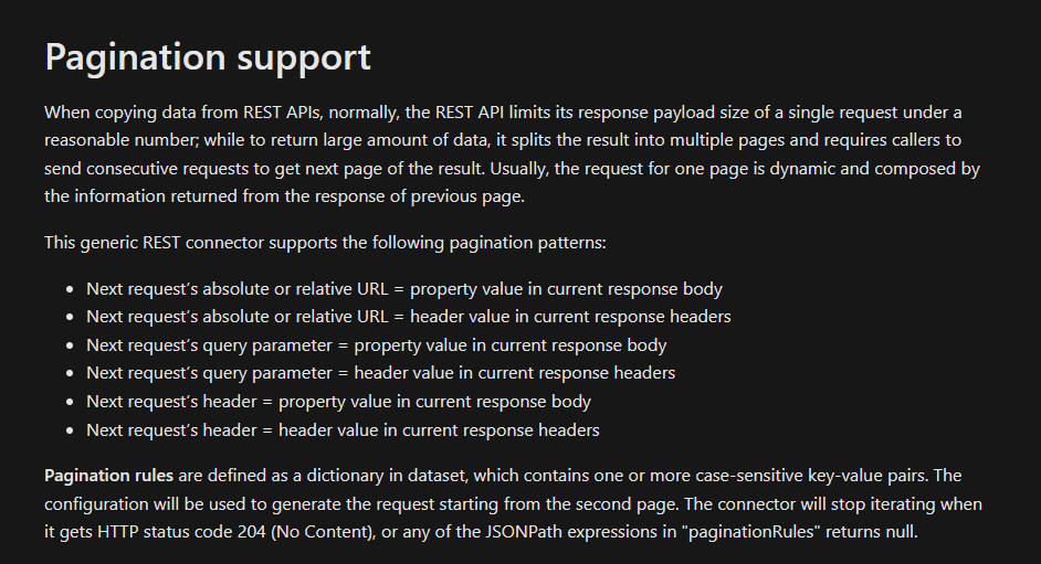

    The reason you are getting only 100 records is that 4me API requests that return collections of records are always paginated. The default page size of 20 records can be adjusted by setting the ?per_page= parameter. The maximum number of records per page is 100.
    If you expect records to be more than 100 then you will have to implement pagination in ADF.
    For more info, please refer to this doc: ADF REST Connector Pagination support.
    You can also refer to this sample demonstration video which can help you implement pagination in ADF: Copy data from REST API which sends response in Pages using Azure data factory.
