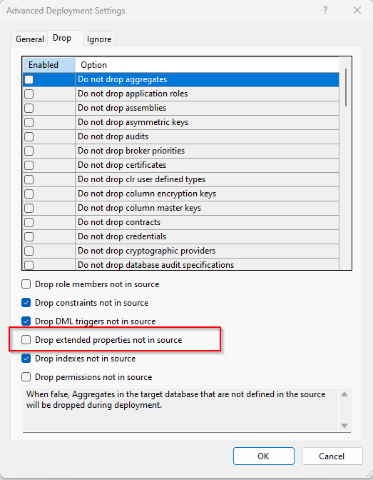

I found an option called "Drop extended properties not in source" (under Project properties>Debug>Advanced...) - but unchecking that doesn't change the behavior in regards to the database description.
Is this a bug or is there a hidden setting I haven't been able to find yet?

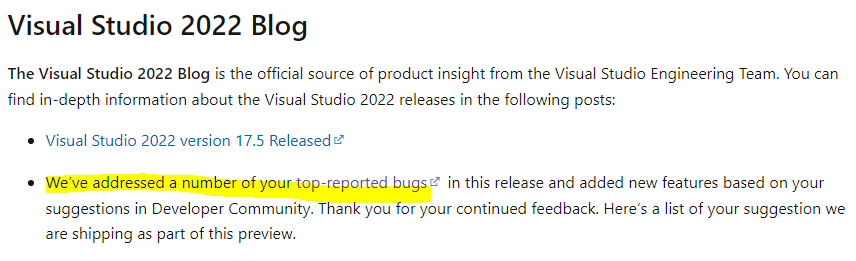

    Please refer to this document:
    https://learn.microsoft.com/en-us/visualstudio/releases/2022/release-notes
    You can post this issue to their feedback site. A fix may be available afterwards.
