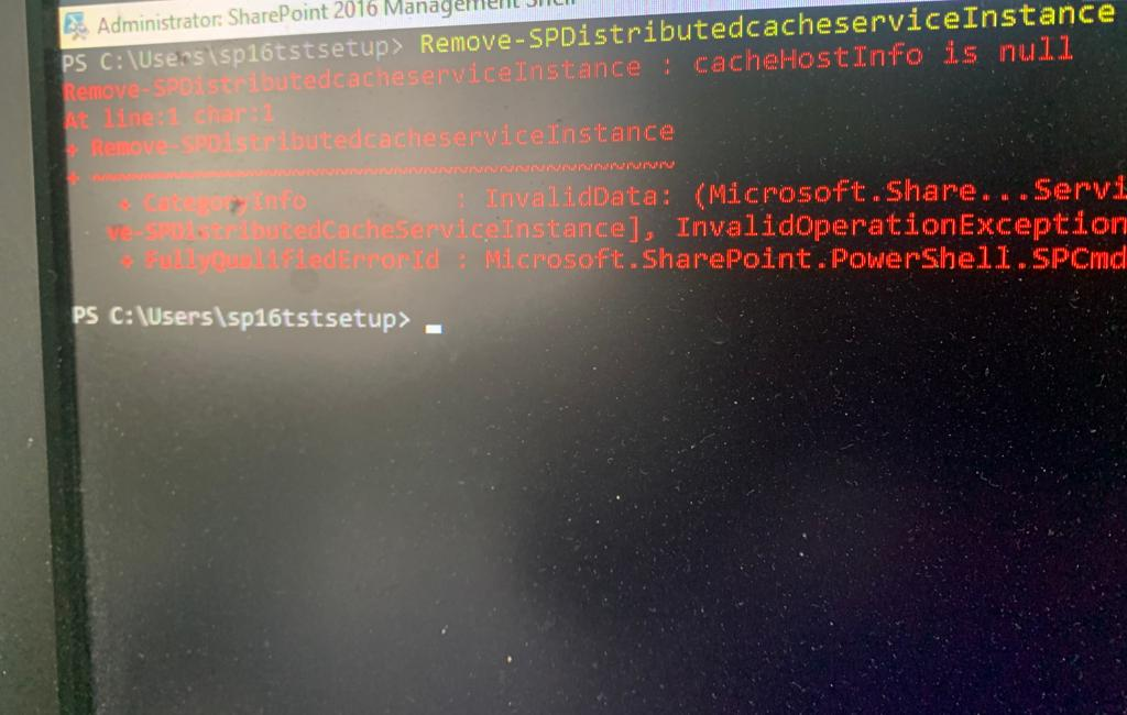

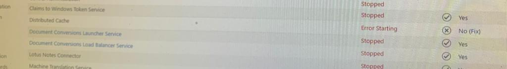

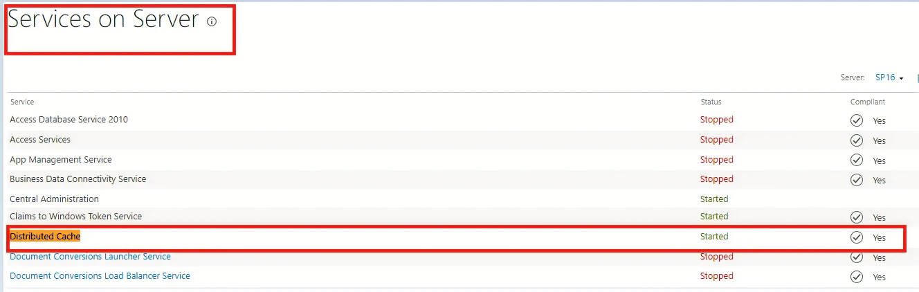

so Noticed distributed cache is not configured in our farm although there are dedicated distributed servers. Please refer below screenshot

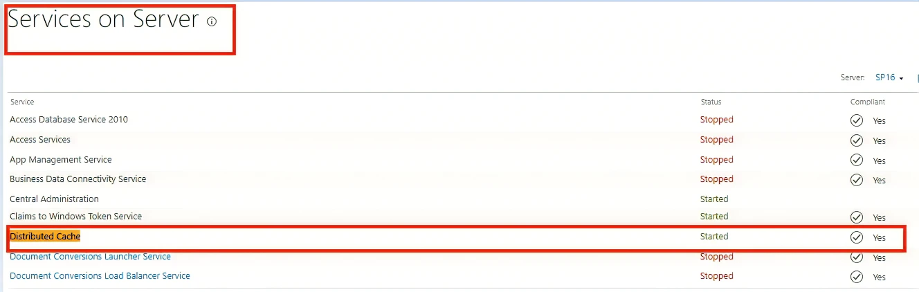

and when I click on Fix, it is loading and giving below warning and when I continued it is still showing message that it is not configured. Please refer below screenshot.
Please suggest how to configure it?

    Hi @sns ,
    You don’t have to do anything to get distributed cache service features! When you install SharePoint, the distributed cache gets installed and configured automatically!

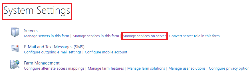

    To start and stop the Distributed Cache service by using Central Administration
    1. In Central Administration, click System Settings.
    2. In Servers, click Manage Services on Server.
    3. On the Services on Server page, locate the Distributed Cache service.
    4. If the Distributed Cache service is started and you want to stop the service, under Action, click Stop. If the Distributed Cache service is stopped and you want to start the service, under Action, click Start.
    Reference: https://learn.microsoft.com/en-us/sharepoint/administration/manage-the-distributed-cache-service?tabs=SCS1%2CSCS2%2CSCS3%2CSCS%2CSCS4
