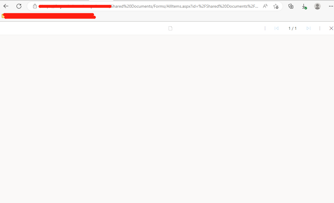

I am try to use a sharing link of SharePoint in browser to access the resource, but it did not work. And this case only happens when the file type is pdf or txt & the file is renamed.
Here is how the case happen for reference
step1 - generate a sharing link
step2 - rename the file
step3 - use step1 link to access resource, return nothing

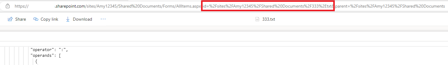

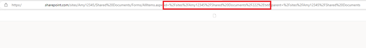

    I tested it in my environment and got the same result as yours. This is because the Share link contains the path of the file. When the file is renamed, the path in the link changes to point to the renamed file. The file pointed to by the previous link no longer exists, so the file cannot be opened.
    03031
    03032
