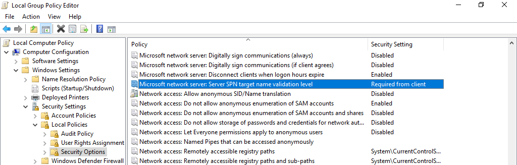

  3. Charles Thivierge 4,181 Reputation points
    2023-03-07T15:49:27.4666667+00:00
    Hmmm... one thing that could be the issue is if you access the server using another name (like a CNAME) and you have enabled the security option "Microsoft Network server: Server SPN target name validation level: Required from client. In that case, if you try to access a file share on a remote computer where there is no SPN for this server name, it will not show any folders / files. But if you access using the IP address, you just bypass Kerberos Authentication and NTLM is used instead.___11111111
    hth
