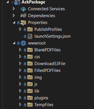

I have an application that writes the data in a pdf file. The pdf file exists in wwwRoot directory inside the application. This is how I am accessing the pdf file:
string blankPDF = Path.Combine(_environment.WebRootPath, "BlankPDFFiles");
    string filledPDF = Path.Combine(_environment.WebRootPath, "FilledPDFFiles")
I am getting the blank PDF file from wwwRoot/ BlankPDFFiles and writing to the file and then saving the file to WWWRoot/FilledPDFFiles with a different name using this code:
 string pathToFile = filledPDF + "\\Package" + "_" + employee.EmployeeNumber + ".pdf";
 pdf.Save(pathToFile);
I am using third party tool to write to the pdf file. This is working fine on my local computer, but when I deployed the code to server. I start getting the error saying
UnauthorizedAccessException: Access to the path 'D:\inetpub\wwwroot\Package\wwwroot\FilledPDFFiles\test1234.pdf' is denied.folder FilledPDF exists in wwwRoot so not sure why it is going to D:\inetpub\wwwroot\ rather than going directly to Package\wwwroot. This is my directory structure:
