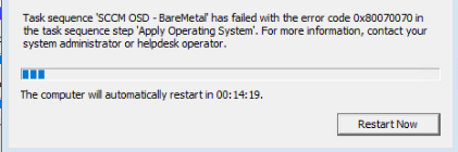

    Issue – Laptops were unable to boot from PXE and it was jumping back to PXE boot window.
    Root case – Systems were already in SCCM database hence OS deployment was not recognising them as unknown system(bare metal)User's image
    Solution – deleted the entry of both system from SCCM database and then it started working. Hence if we want to do the OS deployment on any bare metal [new computer]
    1. Ensure they are not in SCCM database and if they are then delete them to treat them as unknown computer[bare metal].
    OR
    1. Install SCCM client on them and then do the OS deployment.
