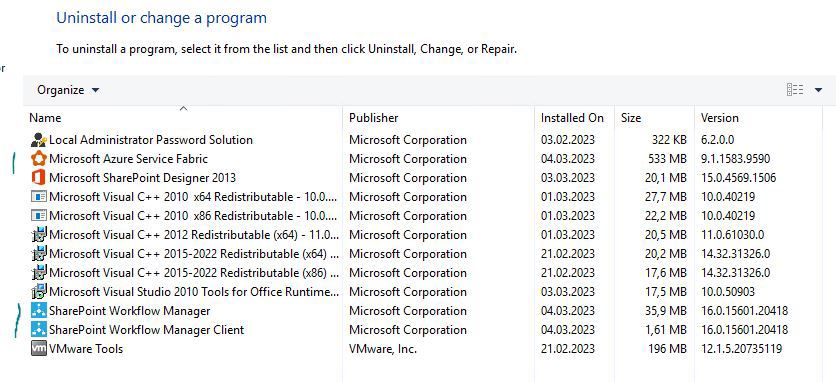

Installing the new SharePoint Workflow Manager ver 16.0.15601.20418 (released 12/26/2022) on a Windows 2016 app server following this guide: https://www.microsoft.com/en-us/download/details.aspx?id=104867.

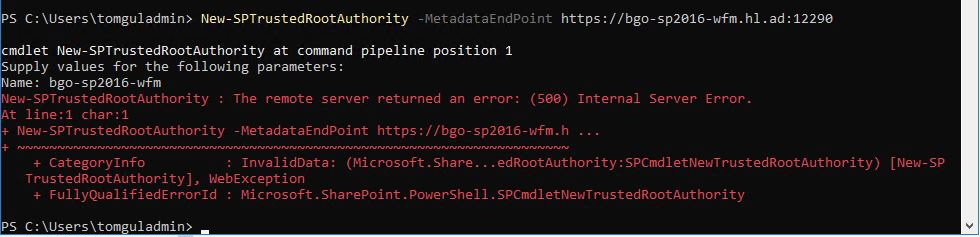

Same error when trying to create a certificate authority on the SP farm server using the WFM endpoint for the WF Farm:
Skjermbilde4
Any tips?

  2. GULLBERG Tom 25 Reputation points
    2023-03-06T13:55:00.75+00:00
    Checked the values in the config file and in SQL and it was the same: 1.5. Did run the queries mentioned in the article though and restarted the systems. Open IIS again to https://bgo-sp2016-wfm.hl.ad:12290 and it prompted a logon window - tried to logon with the WFM setup and the service accounts but ends up with this error:
    Skjemrbilde5
    Same error occurs when running New-SPTrustRootAuthority in the SharePoint 2016 farm.
    Get-WFFarmStatus:
    WorkflowServiceBackEnd = Running
    WorkflowServiceFrontEnd = Stopped
