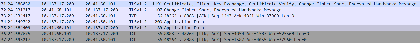

I am trying to connect with a device to Azure DPS, but keep getting MQTT CONNACK with error code 5 (The Client is not authorized to connect).
/api-version=2019-03-31&ClientVersion=1.3.7 | CLEAN: 130 | USERNAME: 0ne001A13DC/registrations/80220928000279
<- 09:36:04 CONNACK | SESSION_PRESENT: false | RETURN_CODE: 0x5
Would you please tell what kind of inputting information involved in MQTT CONNECT request will result in CONNACK(error code 5)?MQTT connection fail.png

    /api-version=2019-03-31&ClientVersion=1.3.7 | CLEAN: 130 | USERNAME: 0ne001A13DC/registrations/80220928000279 <- 09:36:04 CONNACK | SESSION_PRESENT: false | RETURN_CODE: 0x5
    The error code 5 in the MQTT CONNACK response indicates that the client is not authorized to connect. This error can occur if the SAS token used in the MQTT CONNECT request is invalid or has expired.
    To resolve this issue, you should check the format of the SAS token and make sure it is correct. The format of the SAS token should be the same as for both the HTTPS and AMQP protocols: SharedAccessSignature sr={URL-encoded-resourceURI}&sig={signature-string}&se={expiry}&skn=registration The resourceURI should be in the format {idScope}/registrations/{registration_id}. The policy name (skn) should be set to registration.
