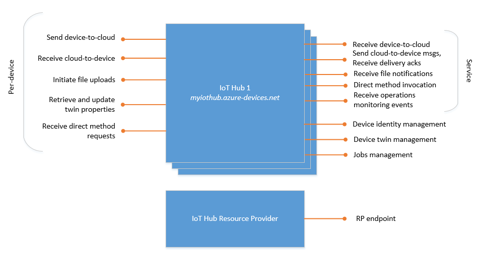

    Diagram showing the list of build-in IoT Hub endpoints.

    Device endpoints. For each device in the identity registry, IoT Hub exposes a set of endpoints, These endpoints are used by the device to Pull the related data.
    Service endpoints. Each IoT hub exposes a set of endpoints for your solution back end to communicate with your devices.
    If you are trying to send a Cloud-To-Device Message using the REST API directly you can't by-design, As Azure IoThub stands like a guardian protecting large scale of devices.
