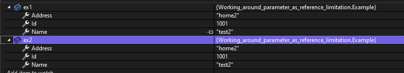

    As the following result shown. the ex1's property's value all set to be the same as the ex2's property's value.
    Hope my solution could be helpful for you.
