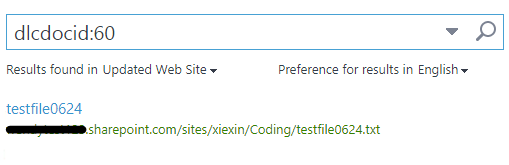

    Per my test, I can reproduce your issues. I created a file called testfile0624.txt in resource library, and the id is 60. After move the file to another library, the id of the file changes to 10. When I search the id 10 in the site, I am unable to find the file. And I search the id 60, It will return the old Url of the file before moving.

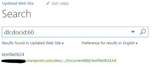

    And after several minutes, I refresh the page, the url turn to the target library
    But I am still unable to saerch the file by new id 10. After I check the Document Unique ID, the id is RAYTHEON-503069472-60. The unique id hasn't been changed after moveto might cause the result.
    I feel regretful to inform you that it turns out to be a by-design one. I noticed that some end users have also proposed the same request, it is highly recommended that you can vote this ticket. Many features of our current products are designed and upgraded based on customers’ feedback. With requirements like this increase, the problem may well be released in the future. Thanks for your understanding.
