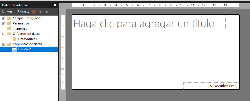

which only searches that table for the record number and in SQL it works perfectly (as a query and as a Stored Procedure), the problem is when I want to pass said query or SP to Reporting Services, I am using Report Builder, when I copy the query I get this window
introducir la descripción de la imagen aquí
and when I accept, it generates the DATASET without fields
I don't understand why this happens if in SQL it works perfectly, I don't know if I'm putting something wrong or missing, if someone could help me how to make Reporting Services read this, I already tried to create that query as a stored procedure and even so It gives the same error and I need to do it that way since it is the fastest

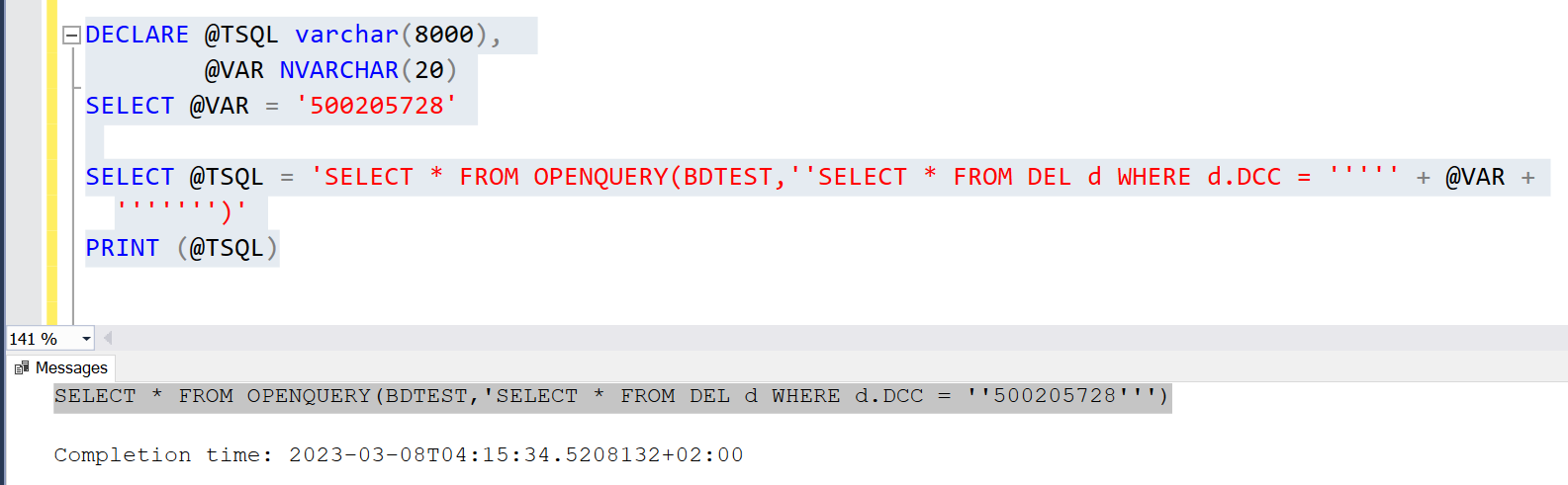

    Your code is wrong regarding the number of quotation marks, which you use.
    You should always PRINT the query and check how it is looks like when using dynamic query.
    if you will try to run the following code (printing your query), then you will see what query is actually pass to the server and you will notice that it is wrong
    DECLARE @TSQL varchar(8000),
            @VAR NVARCHAR(20)
    SELECT @VAR = '500205728'
    SELECT @TSQL = 'SELECT * FROM OPENQUERY(BDTEST,''SELECT * FROM DEL d WHERE d.DCC = ''''' + @VAR + ''''''')'
    PRINT (@TSQL)
    The result is this test which is not well formatted SQL :
    SELECT * FROM OPENQUERY(BDTEST,'SELECT * FROM DEL d WHERE d.DCC = ''500205728''')
    Try to use this:
    SELECT @TSQL = 'SELECT * FROM OPENQUERY(BDTEST,''SELECT * FROM DEL d WHERE d.DCC = ' + @VAR + ''')'
    Fix your quotation marks and you should get the expected result set probably

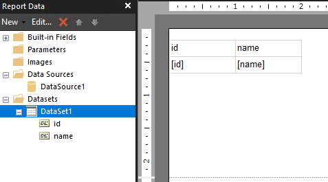

    In fact, I'm not particularly familiar with T-sql. According to the window you jumped out, it seems that the @Var value you set is not passed.
    I did a simple test, created a Linked server, and used a statement similar to yours, but it works in the report builder. Of course, the stored procedure I created can also be used. What is your statement to create a stored procedure?
    For more details, you can refer to this link: https://stackoverflow.com/questions/3378496/including-parameters-in-openquery.
